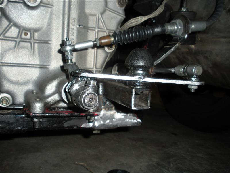

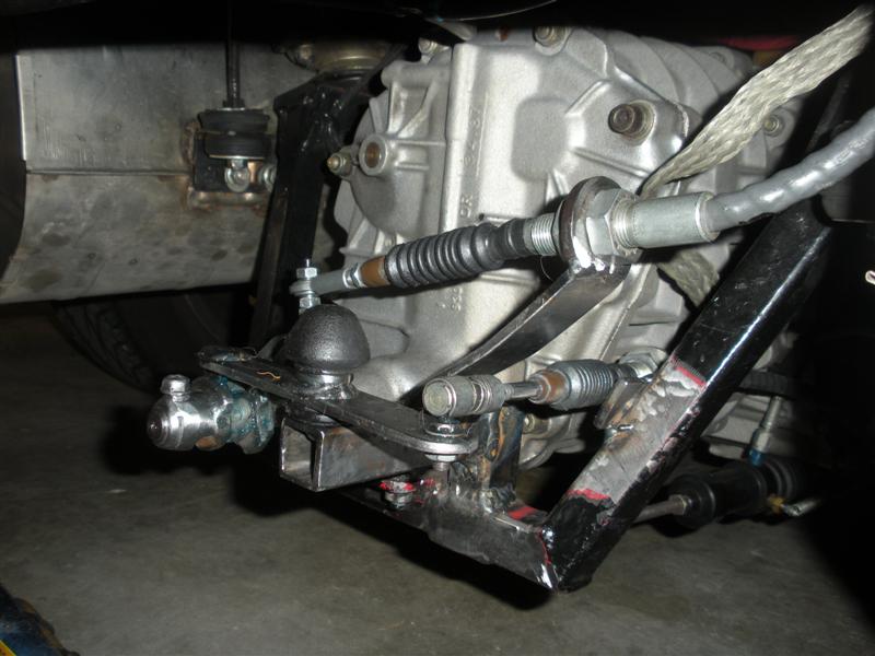

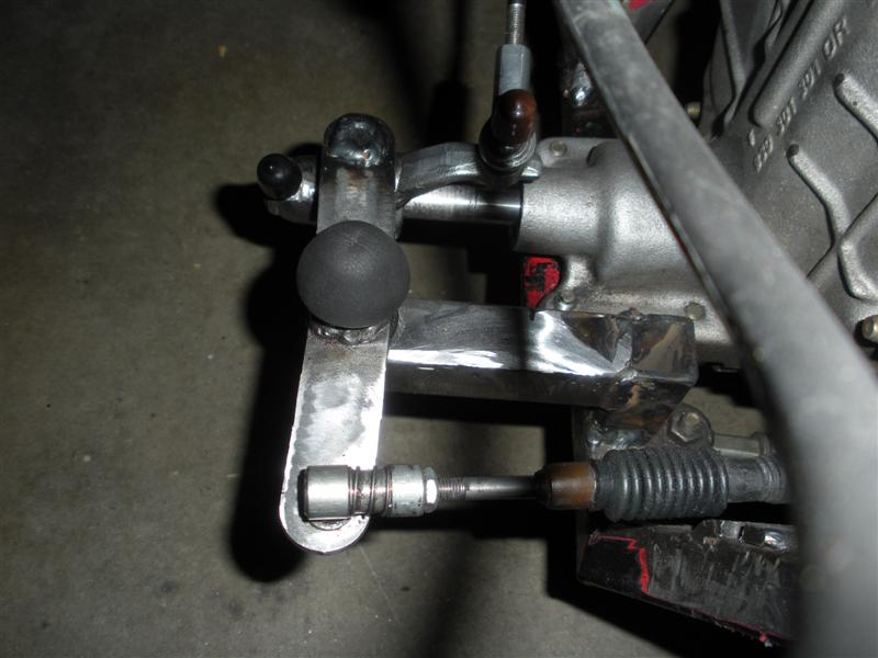

This is the basic idea, use a proven system. Cable to mechanical. This is a MR2 system.
IPB Image
IPB Image
IPB Image
I am running a 930 transmission and its shifting characteristics are well known, it's a heavy slow gear change motivated me to try something else.
The system works much better than the straight cable. My "H" pattern is flipped as I need to install a new shifter unit which matches the back side. I've only driven the car one day and I love the direct feel.
It feels like a modern transmission now, well real close for sure. The 930 transmission shifts like a tractor LOL. I'm going to remove the transmission brace tomorrow, sand down everything and put a fresh coat of paint all around.

930? Cool. It's called the SLAP (shifts like a Porsche) syndrome, and it's amazing how much a cable shifter can make that better. It transforms the whole car and the way you drive it, no exaggeration. Somebody should do a bolt-on kit and put all those unwanted but perfectly fine tailshifters back to work.

OK, I had something like this. The problem as I see it is the amount of force needed to move the transmission rod in and out. Rotation is no problem. The 930 4 speed needs some leverage gain on the other side of the cable. Just pushing it cable end to cable end seemed wrong. I know lots of cars run them but nothing factory made does it this way.

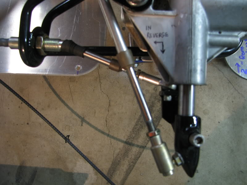

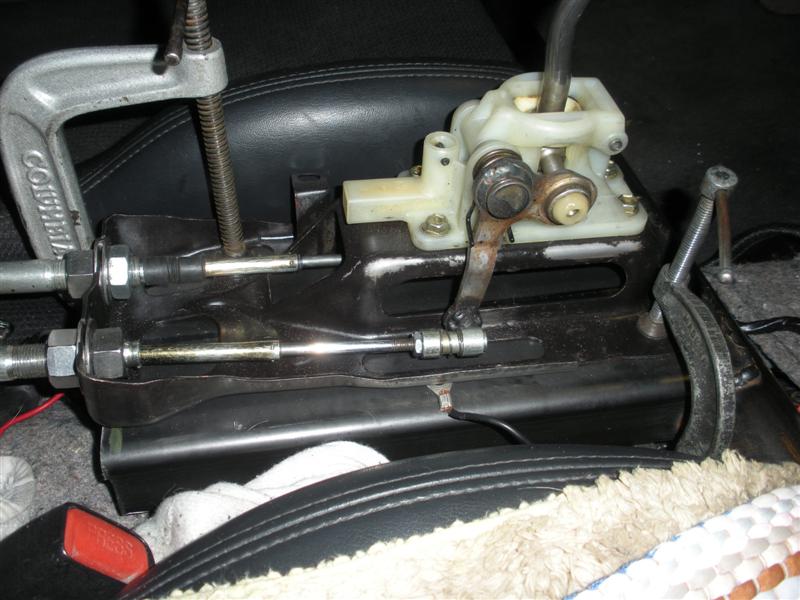

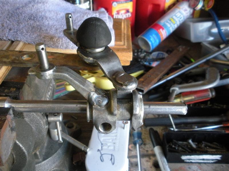

I have done a bit more work on the linkage to my V8, 930 transmission. I swapped the shaft twist pivot to the driver side because among other things reverse needs a pull motion rather than a push with this cable set-up. I chose this shifter because it simply gave me much more leverage. I have been driving for a day or so using clamps which lets me move the base around to get a idea where the best placement might be.
I think this is the best my 930 has ever shifted, among being tighter having a shorter throw its direct feel is fantastic. Where before I had a hard time finding first gear wile downshifting, now its there and snaps in perfect.
It might not look like a lot of work but believe me it was a painful process. I tried
a lot of different angles, used a few different leverage factors to get things to work well. The speed of my shifting has improved quite a bit as well. I really don't know why all the shift linkages on the market for the 930 don't use this type of design, most factory cable systems all use a mechanical mechanism at the transmission. If it were easy to build I might make a few and sell them. I know for me its a huge improvement.

You're going to have to devise a way to keep the dirt and grit from getting caught up in the grease and those sliding/rotating parts on the tail of your trans. It will eventually lead to problems down the road.
I would be in favor of a bell crank for the gate (twist) function mostly to get rid of that looping cable. A bellcrank to translate the motion would give you a nice straight shot from the shifter tower to the trans. Straight push-pull cables exhibit a lot less friction and wear than one's that make curves or loops (you need advantage you can get to ease the shifting on that 930)- though they are designed to take devious paths, they do perform much better the straighter they are.
Where BTW did you get those rubber bellows on the cable ends?

I agree the cables work best in a straight line. The 930 only needs to twist a few degrees to move from 1-2 to 3-4 gates. good idea (now you've given me more work to do LOL) . I got the rubber parts from other apps via pick a part.
