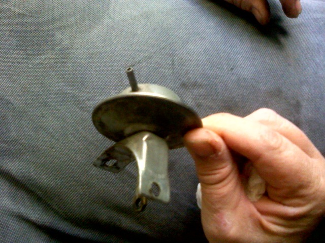

Is there any 2.0 L distributor that uses a single port looks like advance only?
Click to view attachmentThis one came with a 039 905 204 A distributor that I picked up, does not seem right, for my late GA case, retard only.

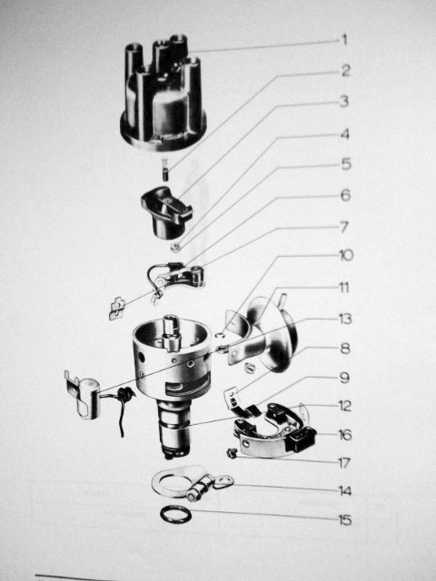

But this image from the Factory Service Manual in the 2.0L section, the dizzy shown is a single vac with the connection for advance only, generic photo?
Click to view attachmentAny ideas?
Mike
Dave_Darling
Jul 25 2011, 12:02 PM
Unless something is drastically different about the internals of the dashpot you are showing, the fitting on that one is the advance fitting. Points away from the distributor body. I think it probably isn't original, but I definitely haven't seen everything that's out there...
