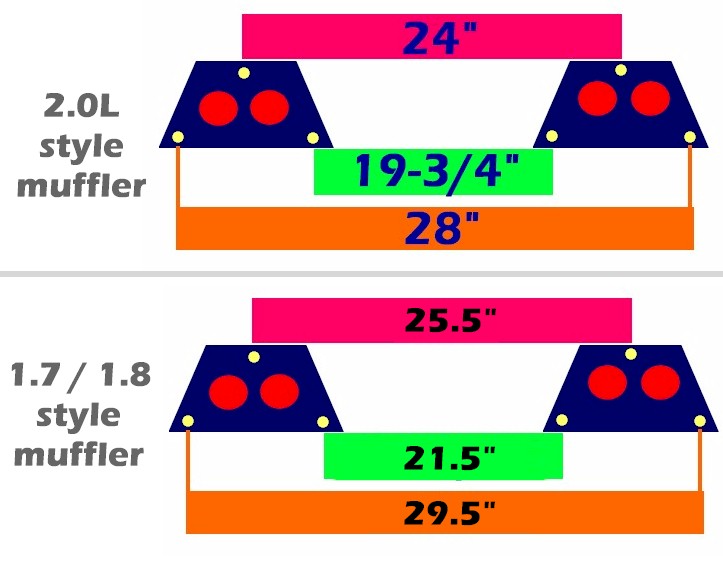

Click to view attachment2.0 copper head gaskets
2.0 muffler
2.0 muffler hanger
2.0 muffler gaskets
2.0 heat exchangers
for possibly some hp increase?
