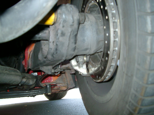

here's what i did, in that order:
19 mm master cylinder
'86 carrera front brakes, vented and crossdrilled rotors, carrera calipers
'87 carrera rear brakes, vented and crossdrilled rotors, carrera calipers
replaced brake bias valve with a open "T"
braking is perfect now
Andy
Jul 6 2004, 12:18 PM
oops, forgot the pic ...
