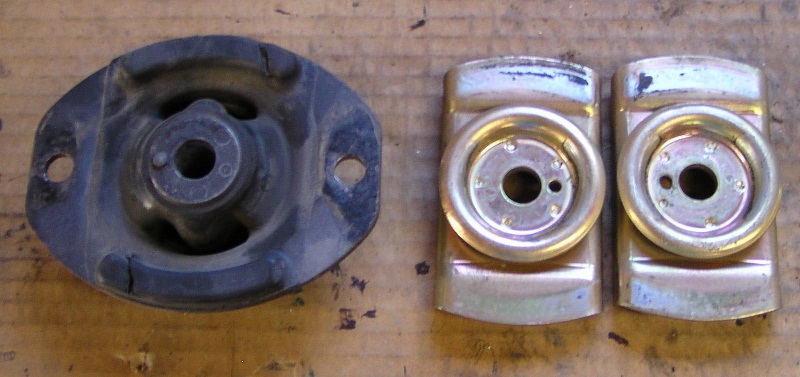

I had a vibration in my car recently and the problem turned out to be the transaxle mounts. They looked fine but were sagging from age. This caused the bump stop to hit under certain conditions and it would tend to keep hitting from the rebound and you would feel a vibration in the seat of your pants and in the shifter. New mounts cured it completely.
You can see where the steel bump stop plates are worn and marked from hitting the rubber stops on the mount.
