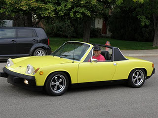

Well after about 12 years sitting the 914 finally came out of the garage and ran up and down the street!!Click to view attachment
