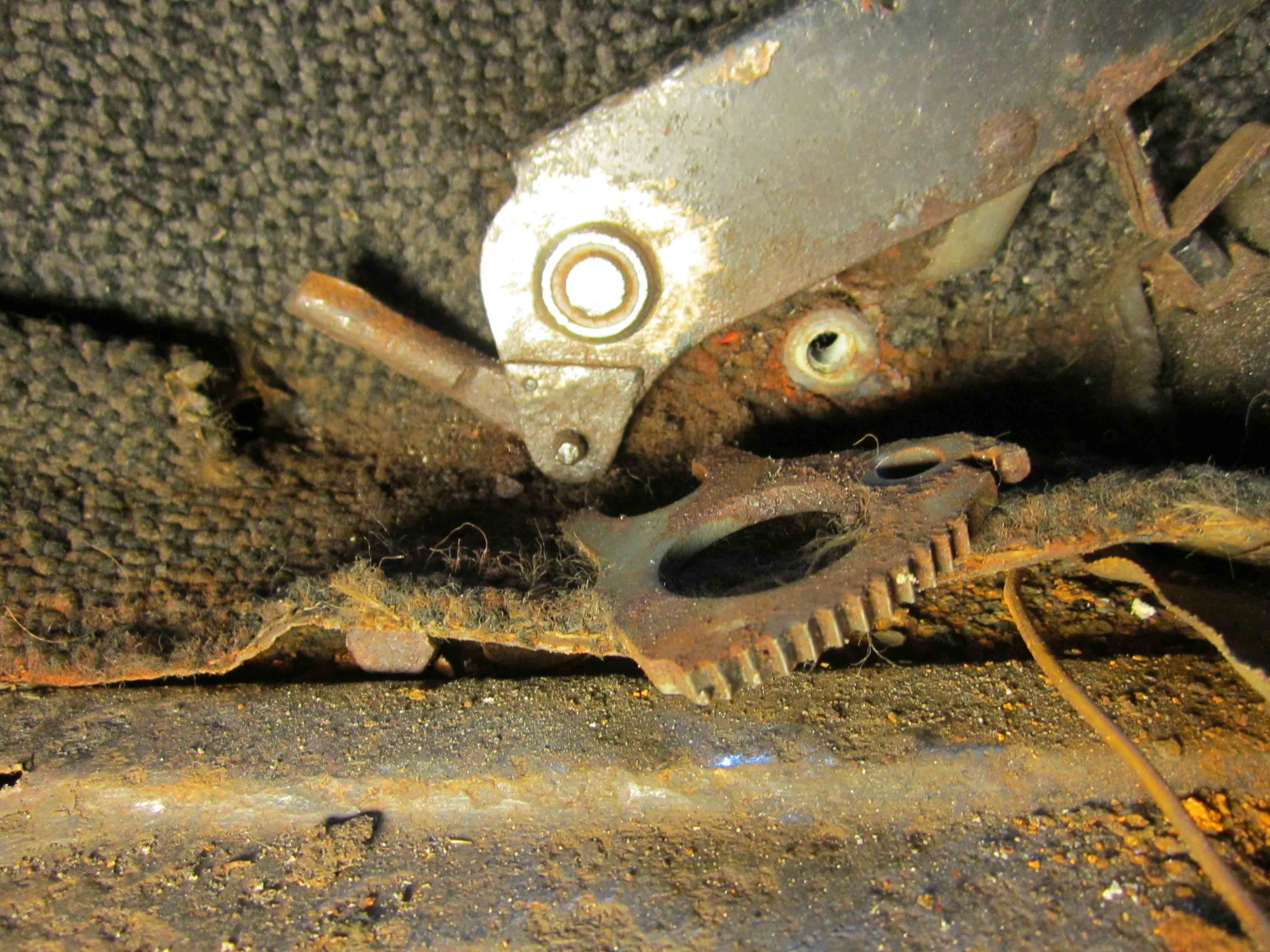

It's just rust on the pivot that is keeping it on. If you take a blunt prying instrument put behind and pry gently as you rock the handle it should start to move out. Move the instrument with the handle, put paper towels all around it to keep from scratching the back. It helps to start by moving the handle up and down vigorously first. The rust will act as an abrasive against the plastic bushing and you'll see plastic shavings and rust powder come out. By then it will be loose and you'll need a new bushing.
