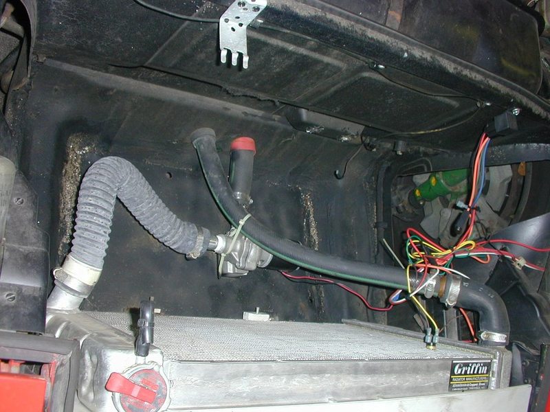

I'm slowly going through this car trying to get it sorted. I'm finding a lot of little chicken shit issues that someone clearly half-assed along the way. As Scott has said, "they knew just enough to make it work".
I just re-wired and cleanly ran this wiring rat's nest in the front trunk yesterday... rolleyes.gif
