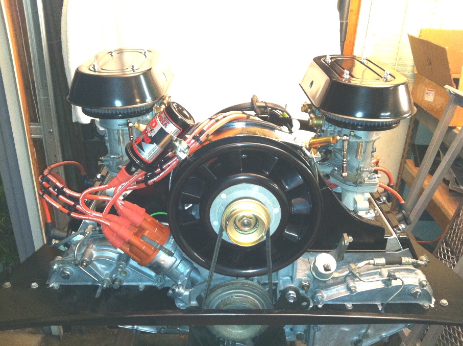

pcar916
Kinda depends on your access cover. I have mine (no carpet) edged with a standard plastic edging strip that has an internal metal clips. The cover is larger than the hole, attaches with Dzus fasteners, and could be carpeted as well to match or contrast with the firewall carpet...
or I could mount the Flux Capacitor there..
Good luck

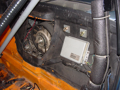

andys
Here's a photo of my access panel.
I'm thinking to make the cut out, then cut a piece of carpet 1" larger all around, then Velcro over the cut out. The cover piece should have edging sewn around it, however that will likely call attention to it. Thought?

Just what does the access panel allow you to get to? How hard is it to remove seats and panel behind seats? Worth inslulating to keep noise down? Bob
I don't know about the guys with 4 cylinder cars other than to access the fan. But those of us with sixes have fan belts, oil pressure sending units, and distributors there. Changing a fan belt on a 911 when it's staring at you is almost trivial. Not so in a 914-6. Take a look at my picture above of what's reachable for a six and you'll see what I'm talkin' about. Changing out a broken fan belt in the middle of the night on a lonely highway is something you only want to do once. Ok, not even then, but you get the point. beerchug.gif
