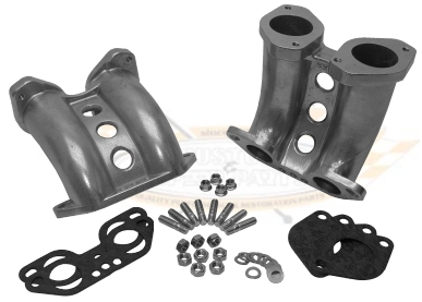

Torque is king in a type four, look at what Raby/HAM uses, they use the tallest manifolds out on the market.
IPB Image
SGB
Yep. Tall is best fore us. I used to have shorty bus manifolds and went to the one's pictured above. Night and day!
Jake can (used to?) build a motor that does take advantage of the short ones too, but it is on a high rpm config- probably roller cam, etc.
Get tall manifolds and the tallest velocity stacks you can fit. My stuff came from Aircooled.net.
