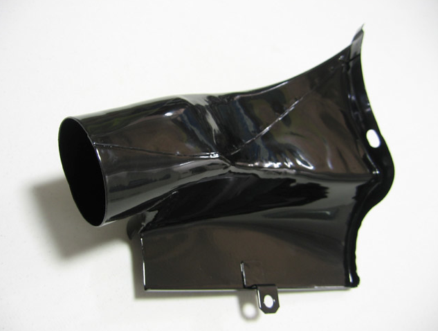

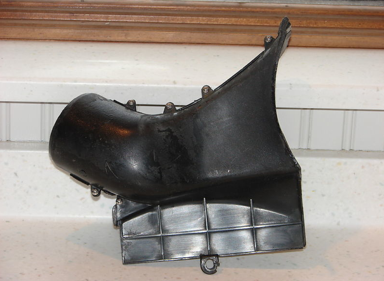

For you conversion guys, how have you grabbed heat from the engine shrowd and directed it to the heat exchanger? My question is focused on the passenger side exit, it seems to me that for post 74' 911 engines, the 'Hot Air Socket' would be a different size hole than the one entering the Heat Exchanger. Do I need to purchase/fab up an older style attachment?
