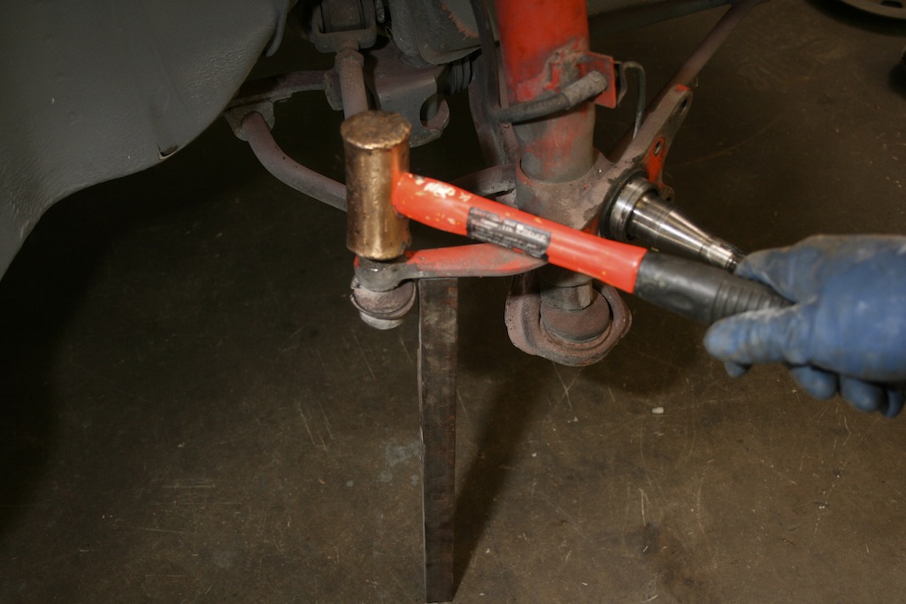

r_towle
I edited the picture posted.
Right where the arrow is pointing..there is a flat spot on almost every one I have ever seen....its directly opposite the arm...so its the weak spot.
all it takes is one really good hit...but its gotta be right on square.
It compresses the joint for just a second and squirts out the tie rod..
Rich

sean_v8_914
notice teh divot in teh center of teh threaded shaft. they all have this feature. I use a blunt tipped round long cone tip on my air chisel. it fits in that hole. hold teh air hammer in straight alingment to the shaft. it will not damage the TR end nor the strut steering arm
