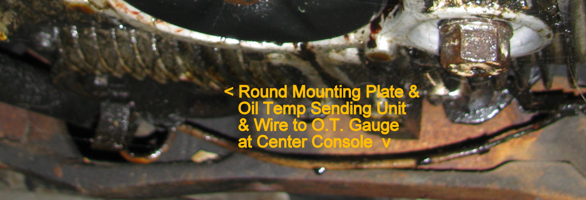

anyone have a picture of a 2.0 oil temp sensor and location?

Oil temp is just for the gauge. The sensor lives up inside a plate on the bottom of the engine, at the left-front corner. The plate is held in by two bolts, and is sometimes called the "taco plate". The injection does not use that in any way at all.

Tom_T
"Taco Plate" OT sensor mounting plate is forward left of the oil sump, with the wire coming out the front, as in pic of mine below.
