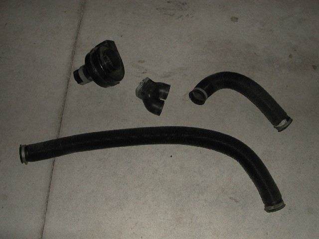

the fan should have a "y" on it and it splits to BOTH sides of the heater ducts in the engine compartment. Neither side is capped off. Here is a picture of the parts needed (not my pic).
73/74 cars had a single outlet fan with one J-tube capped off.
70-72 cars had a dual outlet fan
75-76 cars had a single outlet fan with a splitter

Huh, my '73 had the splitter and heat on both sides. But after years of people tinkering with it I really don't know what is "factory". None the less I think the splitter is the way to go!

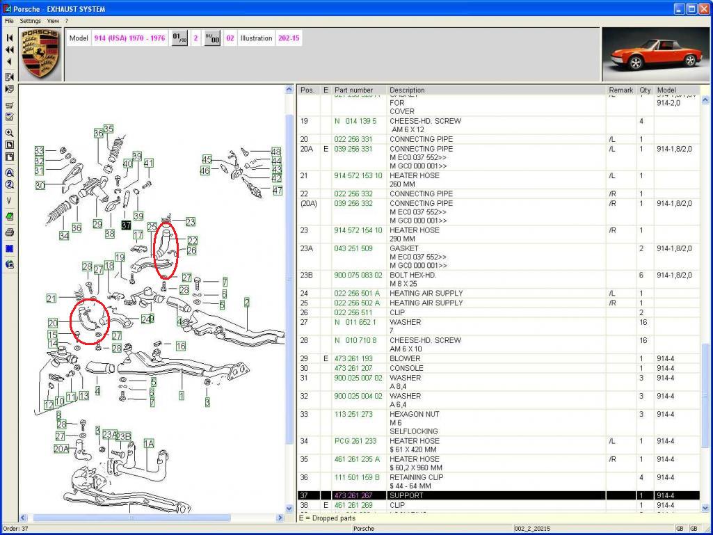

Kent, You have a factory fan mount on the left. You can do this several ways. Either disconnect the "J" tubes and swap them, pull the cap off the left "J" tube and install it on the right one so you can connect the fan to the left "J" tube, or just run a long hose to the right side.
type47
QUOTE(rick 918-S @ Nov 28 2011, 02:59 PM) *
Either disconnect the "J" tubes and swap them, ...
explain. The J tubes are L and R side.
rick 918-S
Technically I guess they call these connecting pipes. I call them "J" tubes.. They stick through the cooling tin.
