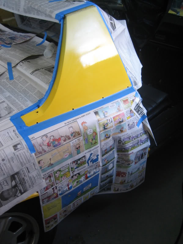

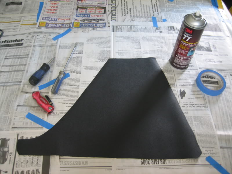

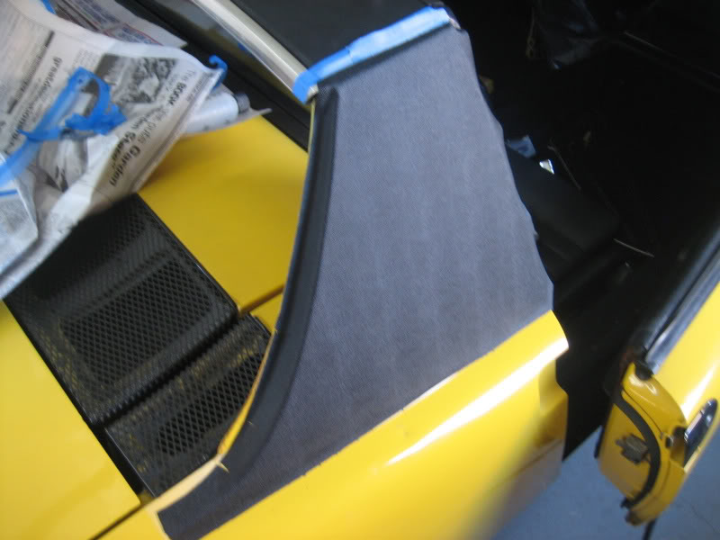

I used 3M Super 77 adhesive. Mask off all the areas that you dont want any glue to get on, spray the glue on both the vinyl and the rollbar in opposite directions, then position the vinyl (helps to have 2 sets of hands). This applies to both top and side pieces of rollbar vinyl (I just now read that you are only doing the top).
