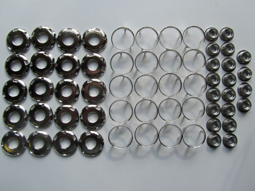

I'm agonizing over what I should do to hold my new german loop carpets down.
I really don't want to glue them in, particularly over all the wires on the tunnel.
I did see these:
Click to view attachmentI remember them from my British car days!
What did you guys do?
