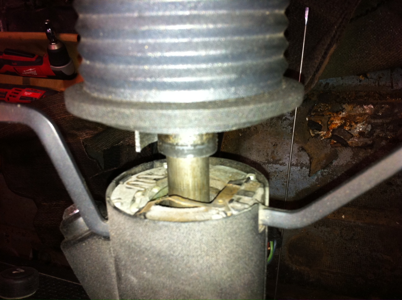

I just purchased a MOMO steering wheel and adapter that I purchased off the boards here recently. The fit of the adapter is unacceptable is there another way to do do this and get the flush factory look? The adapter is fully seated on the splines and the threads are fully exposed.
Thanks
David

eric9144
From the pic you posted, it IS an early adapter--GPR has some of the late ones at a good price, take the early one and list it in the classifieds.

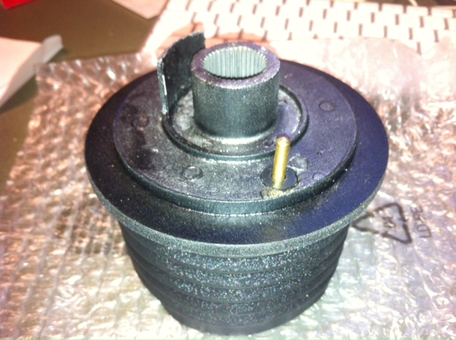

Harpo
Here is another photo of the MOMO adapter. I found a four didgit #2898 but can't seem to figure out what it is.
eric9144
That's the early adapter

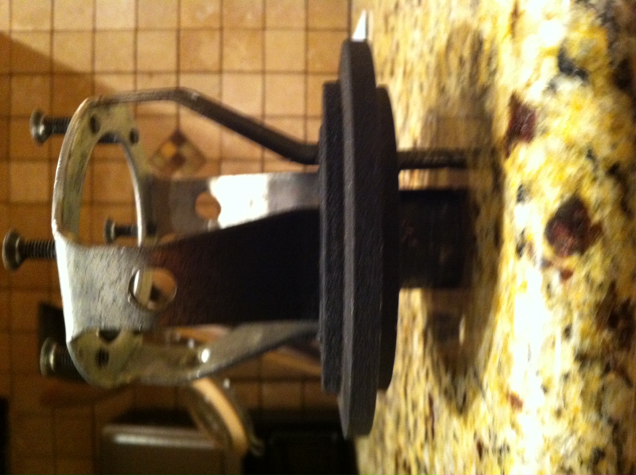

Jim
johnc
thats not the early adapter. The early one is solid aluminum, does not collapse, and fits cars through '71. If I could find one I would shoot a picture.
