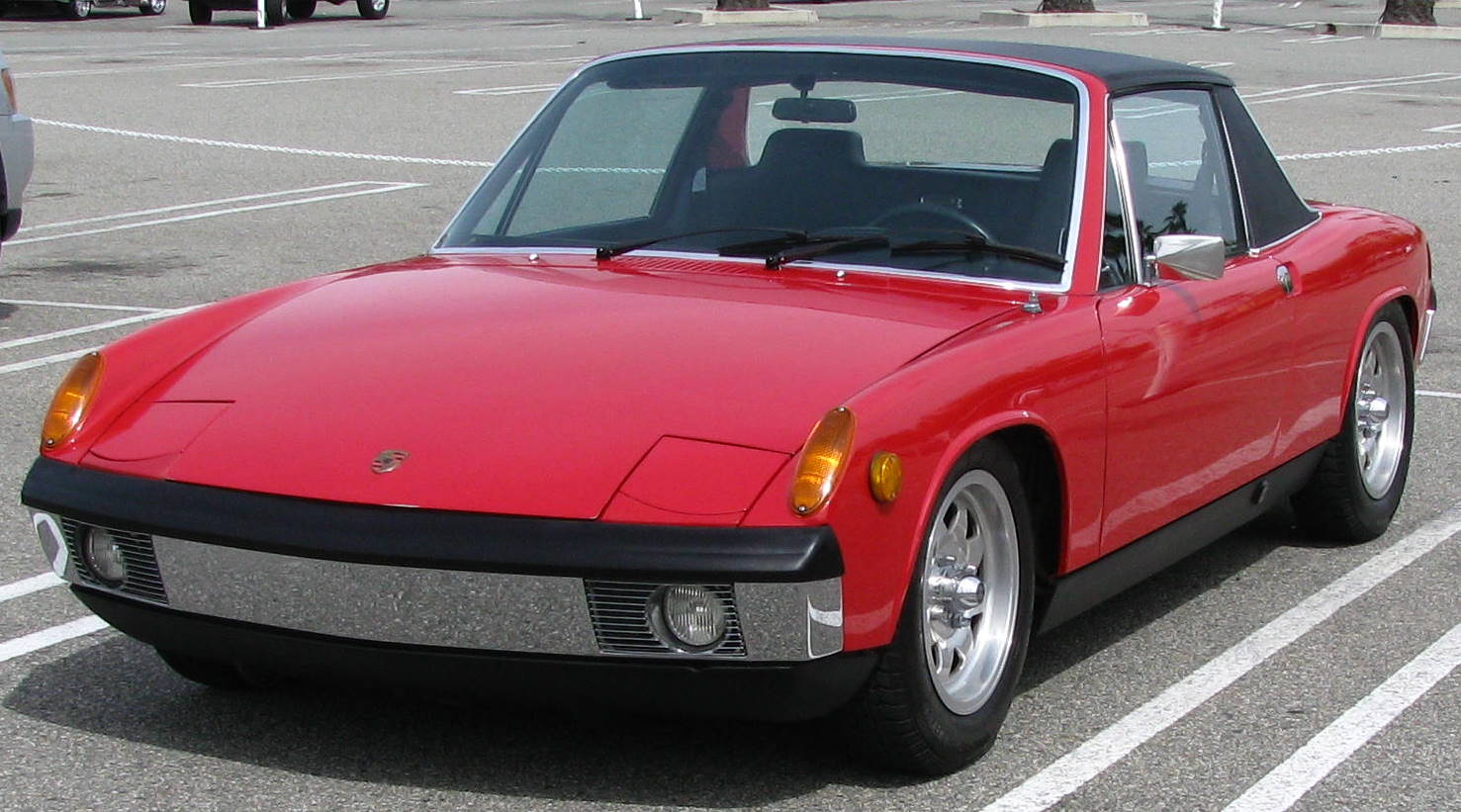

They'll look like my buddy's 71 which had the same dealer swap Rob/Conedodger mentioned above, and are known as both Dan Gurney/Western wheels.
As Rob said, they have a wider offset than stock 914 wheels - being the VW offset for Bugs. So you'll either be pretty much stuck with 165R15 tires - or will need to roll the wells/fenders to get space, cuz they only leave about 1/4-1/2" space between the tire sidewall & wheel well's inner lip.
Ditto the comment on correct lug bolts (there may be one of the current suppliers who have them repro/aftermarket), but the center cap can use aftermarket ones out there today.
Once polished with a little elbow grease, they should look like this.....

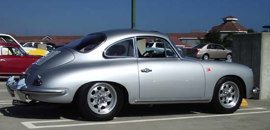

My first 914 (a '71 I purchased in 1973) had them too. I liked them, as they looked like the lightweight racing wheels that Jack McAfee developed for 356/912 track cars in the early '60's (prior to Fuchs becoming available)
http://www.jackmcafee.com/7.html
