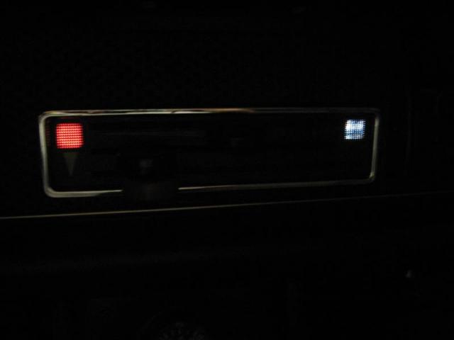

Yeah, one would think that there would be a bulb there to show when the heater fan in on. So I put one in. I took the power from the blue side and used the heater lever as the ground; the light only goes on when the fan is on (the lever is the ground for the fan). I've posted this before, but here is the pic again. Also, I believe that the arrows glow in the dark.
