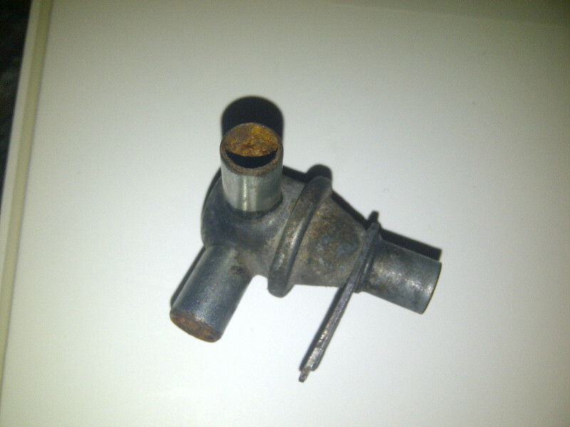

Can someone help me identify where and how to hook up this part of 2.0 djet including mounting location?
PancakePorsche
Backfire suppressor for breather system. Mounts on top of fan shroud directly in front of oil filler. Bottom ports connect to breather tubes on each cylinder head and top port goes to airbox. Prevents crankcase explosion do to backfire being sucked in.

Any pics of where it mounts? I can't seem to see where to mount it .
bradtho
I asked the same question this summer! It mounts on the fan shroud right by the oil filler cap. often called the flashback valve.
