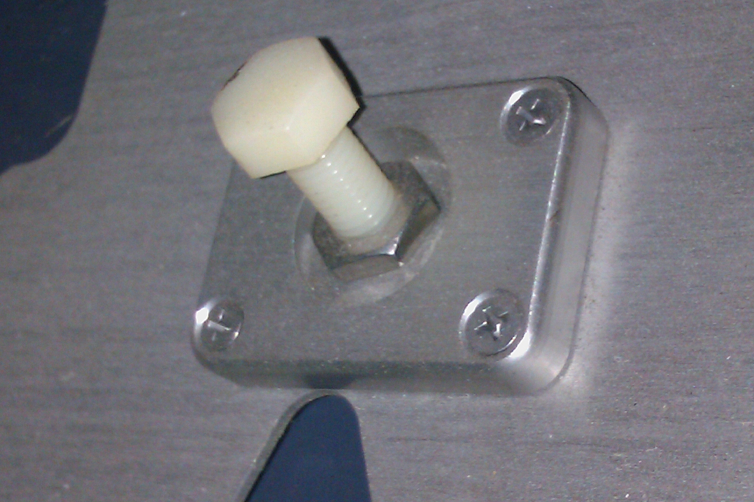

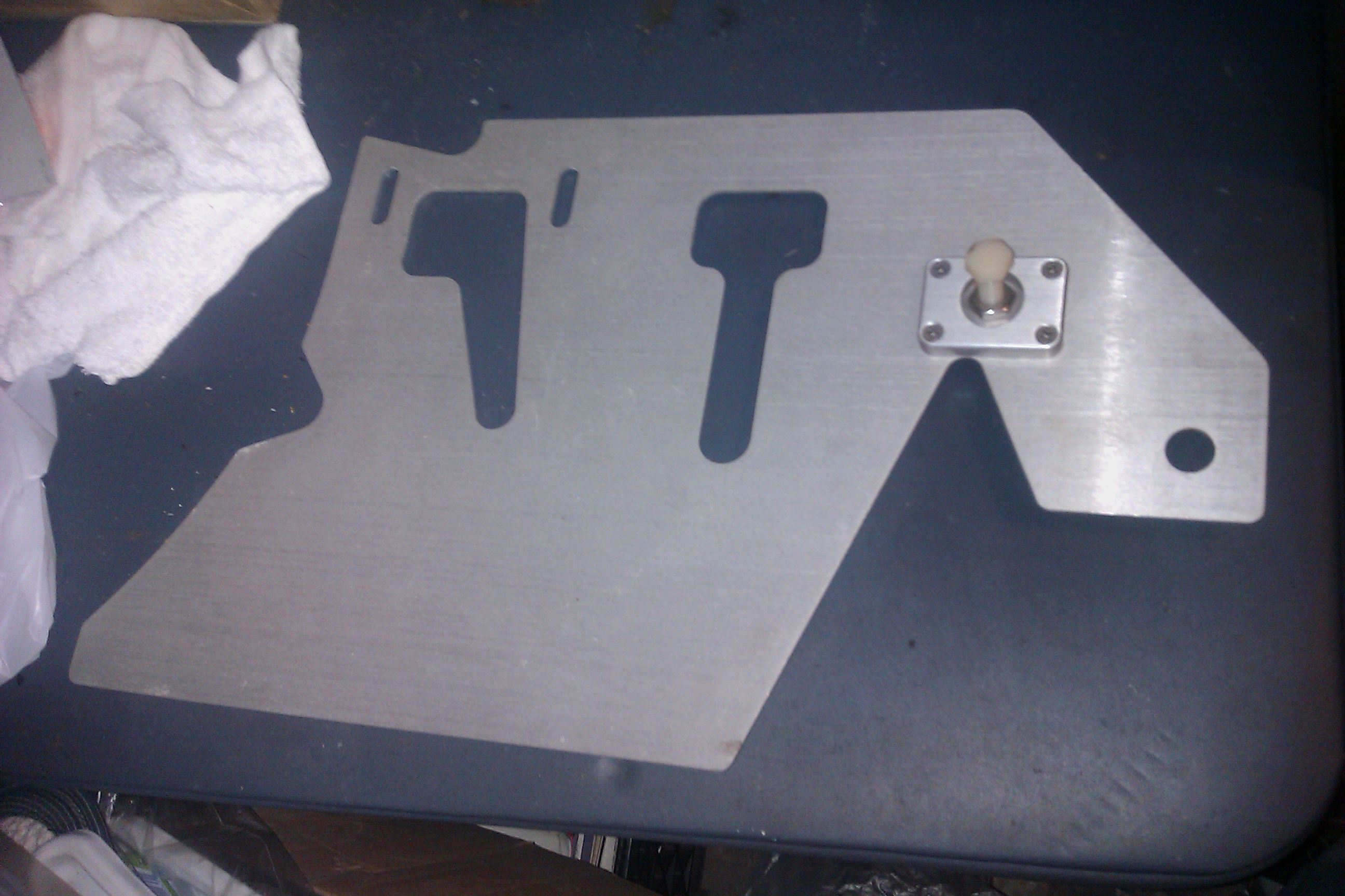

De-populate the pedal board and take it to a lazer cutter and have them replicate
it in aluminum with the correct perimeter, mounting holes and slots, and pedal
cutouts.
I defined the laser tool path in Solidworks and sent it to the shop to be cut and
clear anodized.
I used a 1/8 inch thick strip of solid rubber sheet (1 x 12 in., on left side and
a smaller piece on the center hump.
I mounted a new billet throttle stop base and new white Delrin stop screw.
(for the moment, I forgot where I purchased it, but I will continue to look, and pass it on.)

That looks great. Do you still have the Solidworks file?

I have to look on my old computer, the pedal board was done in 2008.
