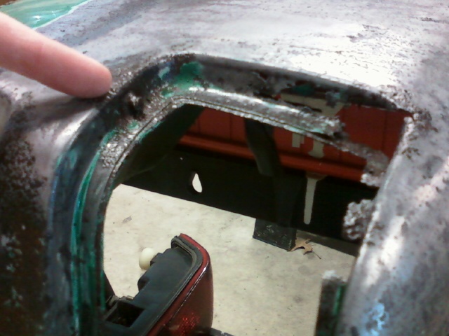

I'm reworking the tail light socket on a donor fender before cutting out a section and grafting into my car. My sockets are basically sculpted from Bondo and are smooth on the bottom ledge but the "good" fender has sort of a nub which looks like it would hold the plastic tail light assembly up against the top of the socket. Is this thing supposed to be here?

Of the 5 cars I have here, none of them have that nub.
scotty b
no
Krieger
I've never seen one.
messix
fender from a 75/76 car?
nub holds bub on top edge.
dlestep

Yes, it's a 75 car. Does this mean that the tail light sockets in the rear section are a bit wider (top to bottom) than the earlier cars that didn't need the nub to hold the bumpers?
I have no frame of reference if somebody wouldn't mind grabbing me a measurement.

"73 is 105 mm.

Two of the chassis are '75-'76 and they don't have the nub.
The others are a '73 & two '74s and they don't have it either.
TargaToy
So what the heck is it? I don't have any experience with the 75/76 cars except that I bought this one as a donor and its bumpers and tail lights had already been stripped when I found it.

That my friends is called a "Unentschieden"
There were two kinds used on the 914. One looked like a raised rivet head and the later was more of a raised pellet. Many of the cars do not have them at all. The first time I actually realized they were a factory part and not a piece that someone forgot clip off was when I saw a new quarter panel.
A small piece of friction tape was used on the top of the head to keep the tailite housing positioned up properly.
