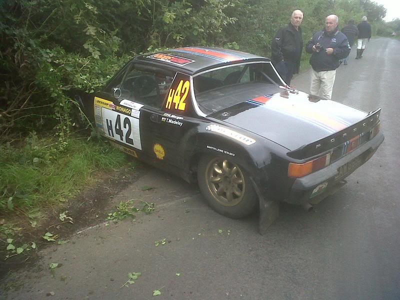

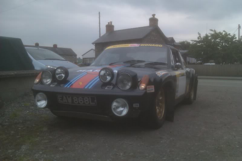

Before the rally, all ready with good intentions to beat some Ford Escort and 911 butt...
IPB Image

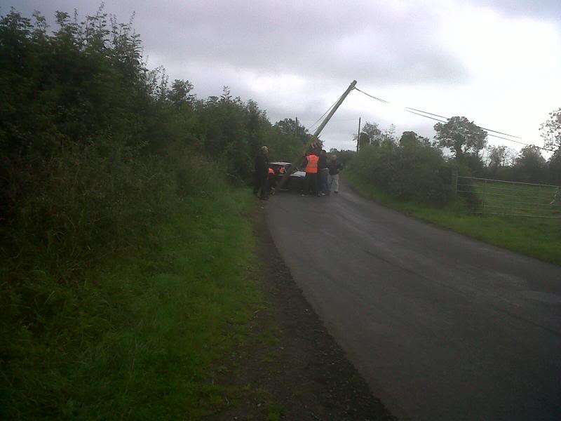

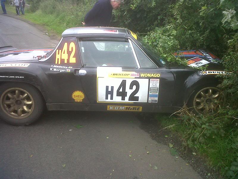

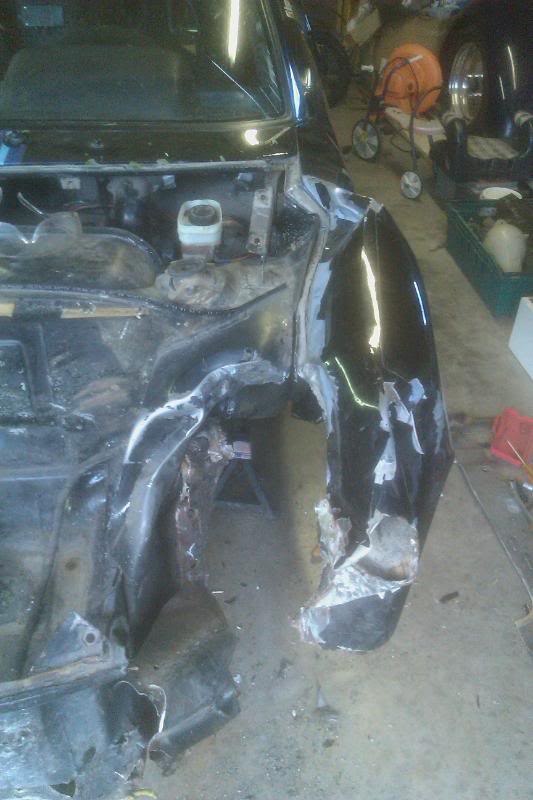

Was going well in 2nd or 3rd in class I think it was until a mistake in the notes caused me to enter into a corner wayyyy too fast ....
IPB Image
IPB Image
IPB Image

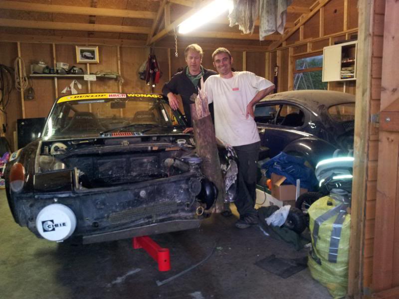

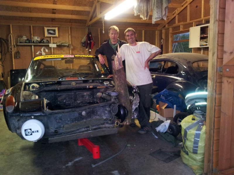

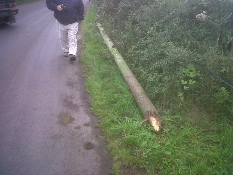

I hit the telegraph pole so hard it sheared a 4foot section off (embedded in the car) and the rest of the telegraph pole remained in Ireland
IPB Image
If the relevant body strengthening and roll cage weren't in place the car would have looked like a banana piratenanner.gif wrapped around the pole (and me looking like a squashed tomato sad.gif )
IPB Image

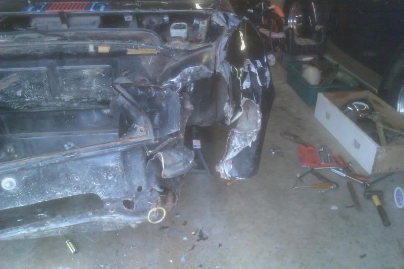

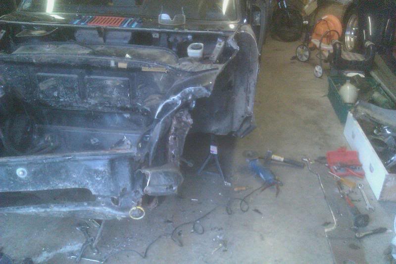

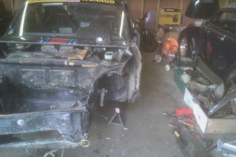

then we started the strip down to see if it was repairable
IPB Image
IPB Image
IPB Image
IPB Image
IPB Image

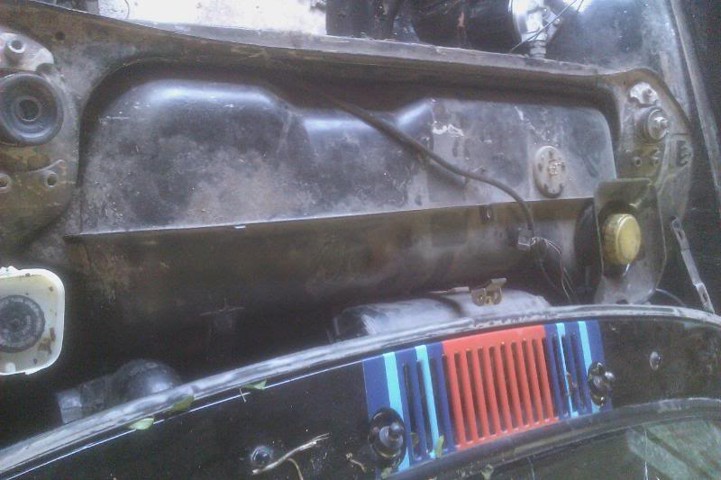

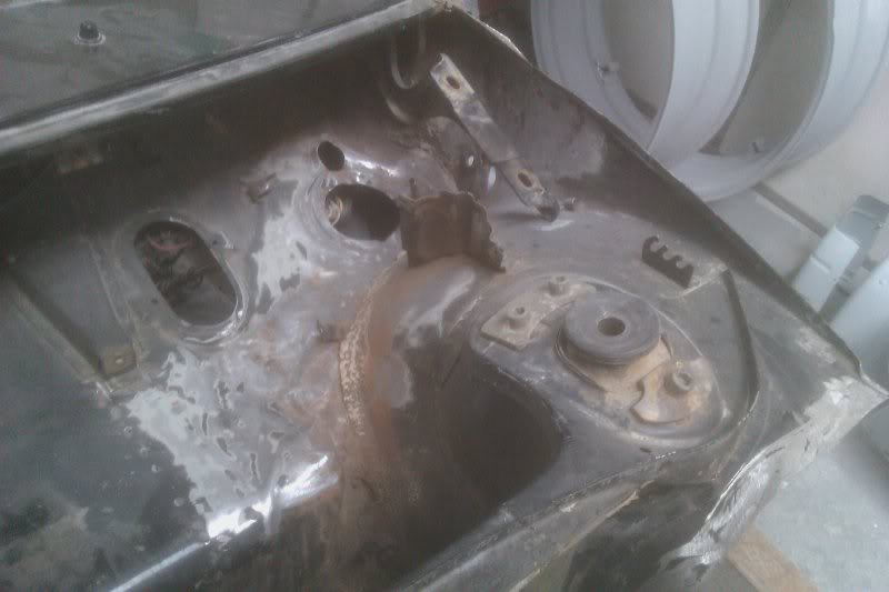

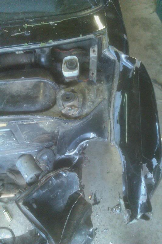

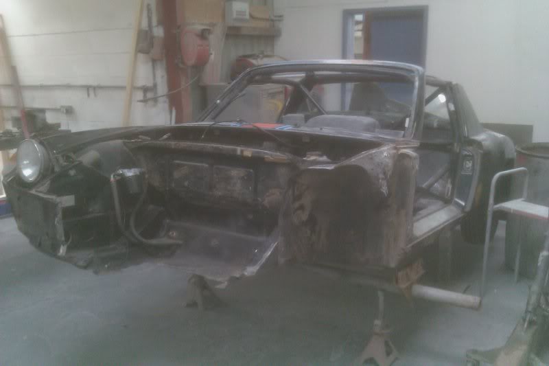

The shunt had essentially pushed the drivers side suspension points back by quite some inches and shifted the whole of the front over to the left by a few degrees. The cage and safety cell were all intact which meant that it could be repaired with a body jig and a new front end (including various other little bits and bobs). The biggest pain in the butt was trying to get the fuel tank out that was crushed into place smile.gif

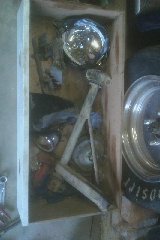

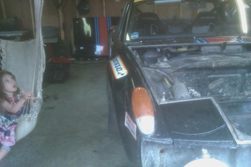

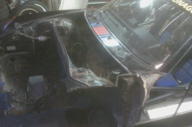

The strip down....
IPB Image
IPB Image
IPB Image
IPB Image

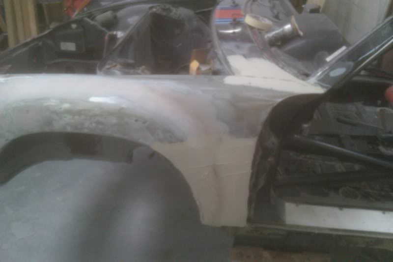

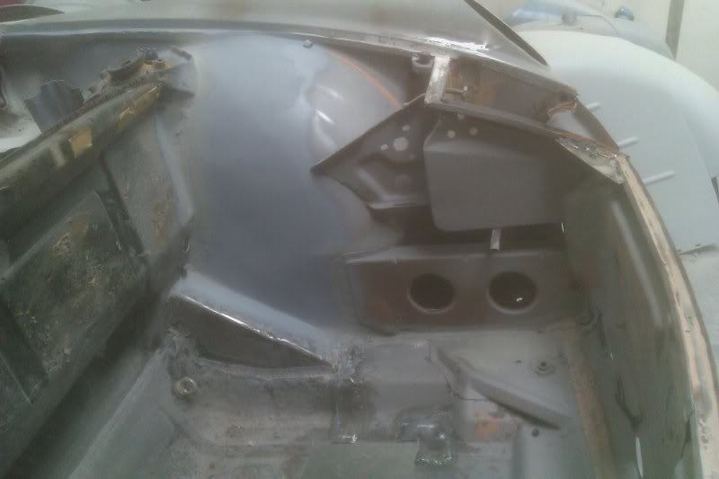

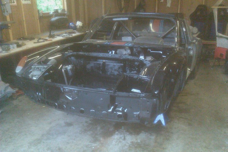

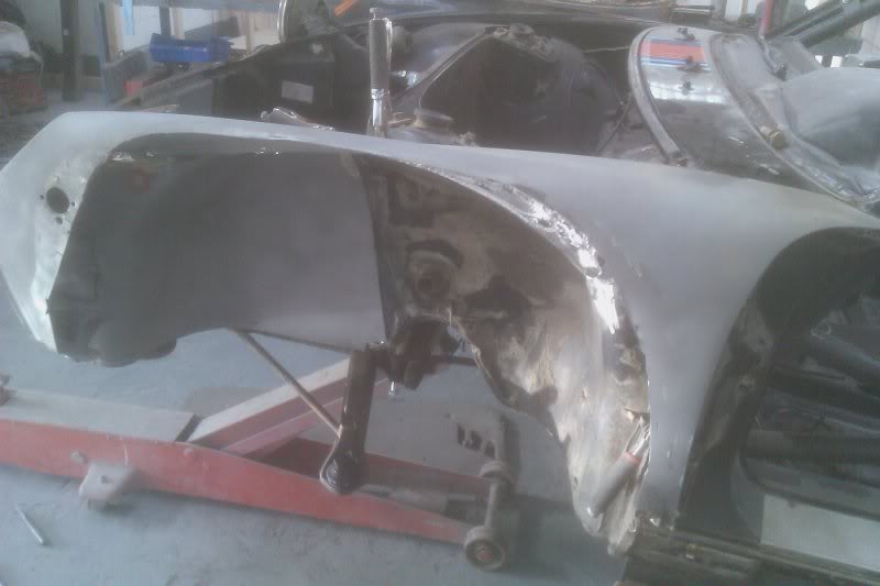

The rebuild....
IPB Image
IPB Image

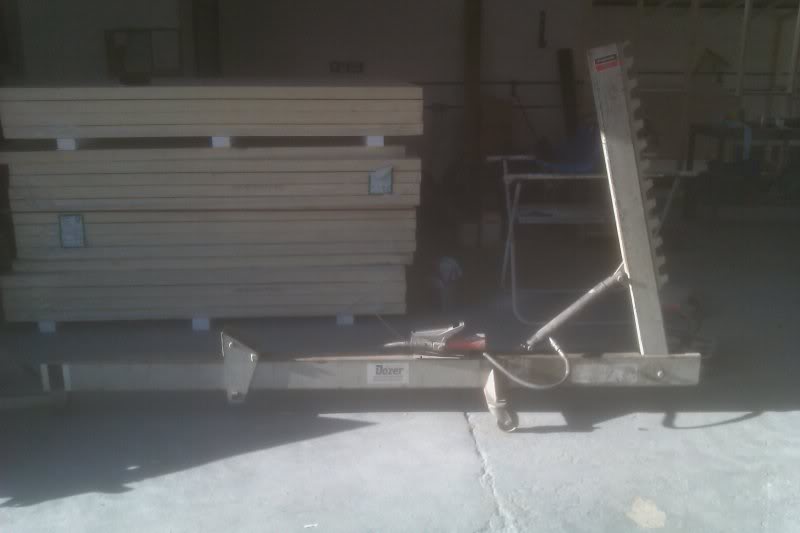

The dozer..
IPB Image

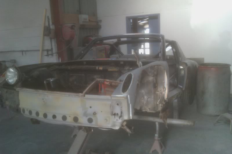

after the front right had the initial pull out
IPB Image

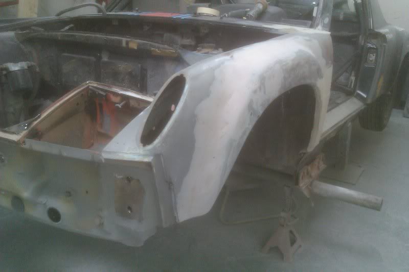

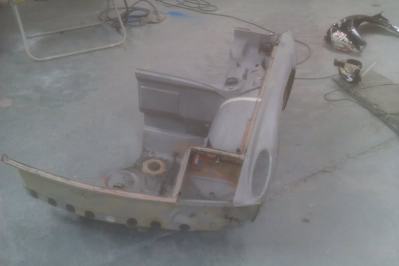

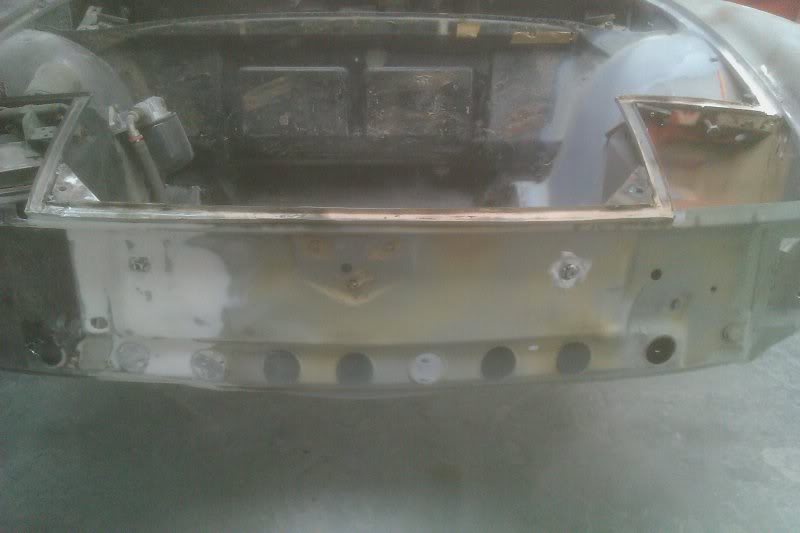

The new front cut out of an old car that was never going to get back on the road again.
IPB Image
welded into place
IPB Image

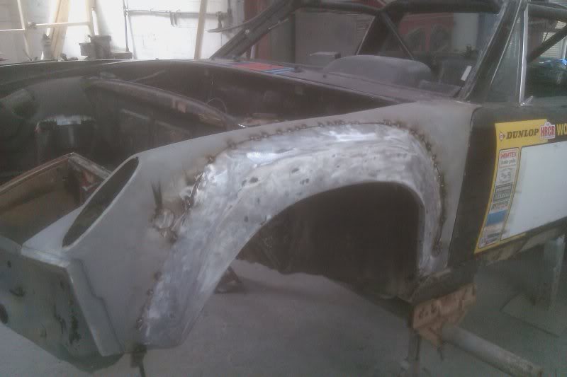

cut out for the wide wing
IPB Image
luckily the old metal wide wing could be beaten back into shape and re-used
IPB Image
IPB Image
IPB Image

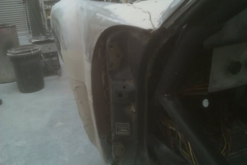

a little bit of additional strengthengin welded in place (bottom left)
IPB Image
IPB Image
IPB Image
IPB Image

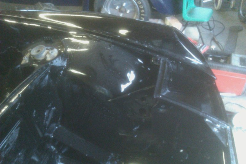

and here we are all painted up and ready to have it's clothes put back on biggrin.gif
IPB Image
IPB Image
