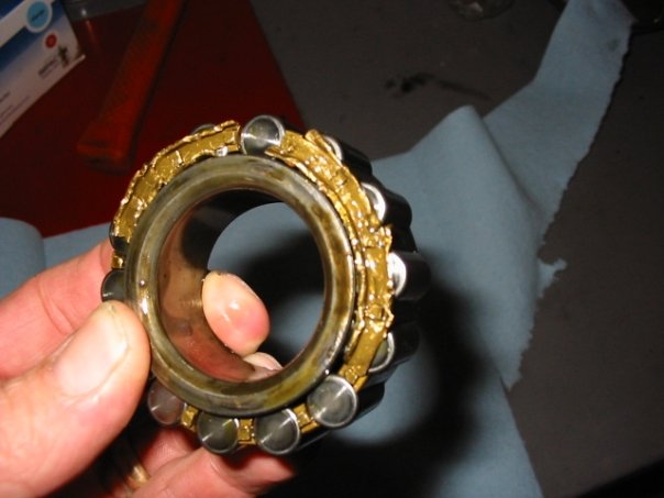

I had the same noise on mine before I rebuilt it and it was the bearing above the pinion gear!!
It fell apart in my hands when I took the trany apart!
Jakeodoule
Feb 6 2012, 08:12 PM
I also had the same problem and it was the same bearing Jeffs9146 is talking about.
Just above the pinion.

Looking like a bearing like Jake pictured. This can lead to badness if left alone.

Yup. It's gotta be pulled apart. The bearing above... now THAT was makin' some racket. When the pinion bearing gets loose it compromises the R&P contact pattern as the pinion is forced away from the ring. Bad carrier bearings can do the same thing by allowing the ring to wobble and be forced away from the pinion.

Just my $.02 but this sounds like what mine was doing with one of the ones I rebuilt and it turned out to be the bearing!
