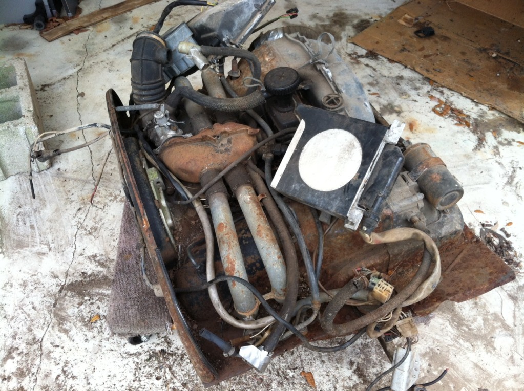

what "might as wells" should i do to it before installation. i know that it ran before a tree fell on the car body and the thing sat for 25 years before rescue as a parts car. i will clean up what i can, de-rust, paint, etc., but...seals? things to tighten, loosen, adjust, replace?

I just pulled the engine (I am keeping the transmission) and without doing anything the engine turned over smoothly with a breaker bar. There is no water in the oil (from condensation) so I feel confident that the internals are good.
I would pull off all the external stuff and clean up/renew as required!
