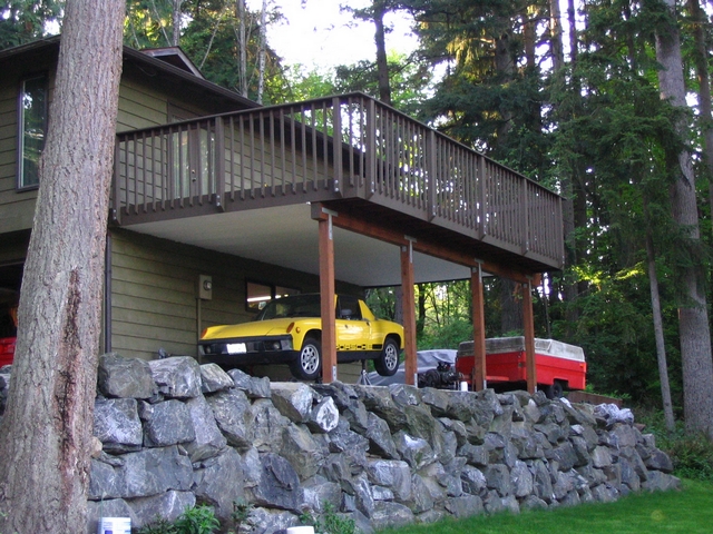

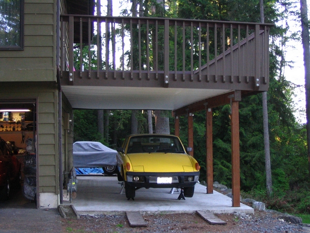

This will ultimatly house the Yellow 73.
Anyone have have any experiance in creating a "Dry" Carport? Im looking for solutions. wink.gif

First you put a roof on, then walls. smash.gif smash.gif smash.gif smash.gif smash.gif smash.gif smash.gif
Looks good, the pitch of the roof is gonna dictate the types of roofing you can use. You're gonna need a fair flashing where you tie into the house. I suppose all of that is already figured especially if you got permits. Maybe Geoff will give you some advice.

Why not just close it in?
If your after the "open look" you could make removable panels for the winter months.

Nah. I may put up some lattice between the post to pretty it up, but Im just concerned with the drip through from the top.
One of the benifits of living in the woods is no one is in your business.
I talked to the county about code requirements while designing it.

Oh, I see...it's a deck! I was thinking it was strictly a carport until your last post. Check out this site:
http://www.dry-b-lo.com/

rich, it will involve some more framing, but you might/should be able to add a secondary roof under the deck joists. sheath it and use rolled roofing. you can get away with a low pitch. if you wait to apply the decking, tuck the flashing under the bottom of a course of siding and you can nail the plywood and the rr down.

So I realized that I had never posted completed pics of this project and how its going to good use! biggrin.gif
rhodyguy
what did you do to keep it dry underneath?

i can't tell what that is. did you just staple some plastic to the bottom of the joists?

No I furred down from the joists, used this polycarbonate roofing and while angling from rear to front and from center to side screwwed it to the the furring with these rubber washered screws. You can sort of see on the inside of the beam is a 1" U channel I used as a gutter angled the same center out to side.

oh, green house roofing. good choise. fire up the enigne yet?
