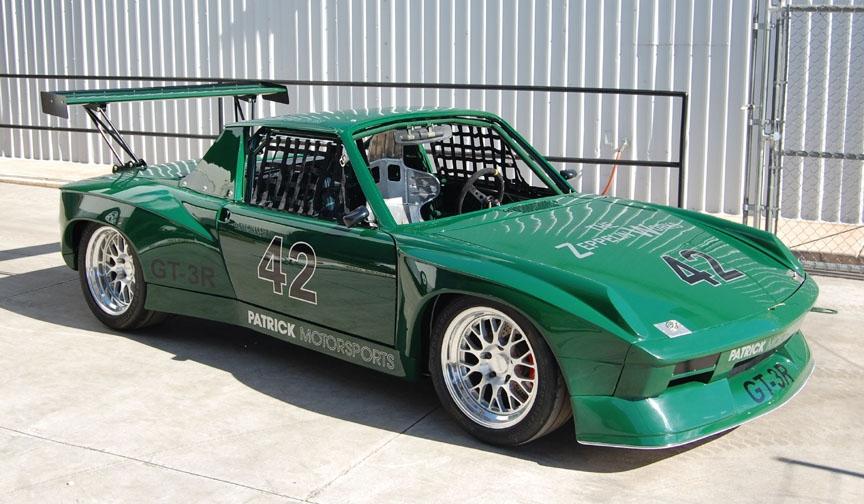

1. Sheridan (Ultimate 914 Bodywork)
Website: http://sheridanmotorsports.com/porsche914.html
Standard Version
Front:
Total Width: 70 3/4" Wide.
Measurement off inner fender well: ?
Wider than stock: ?
Rear
Total Width: 72" Wide.
Wider than stock: ?
Widebody Version:
Front:
Total Width: 76" Wide.
Wider than stock: ?
Rear
Total Width: 77" Wide.
Wider than stock: ?

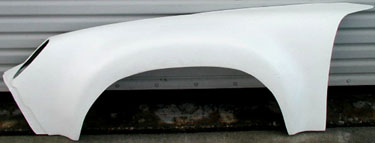

Britain Smith

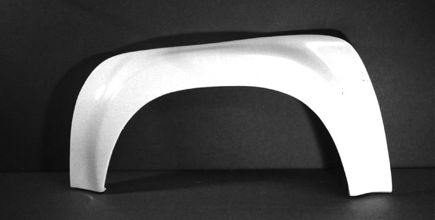

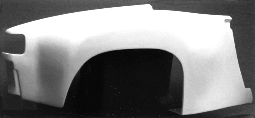

2. American International Racing (AIR)
Website: http://www.americaninternationalracing.com/
SCCA Version:
Front:
Total Width: ?
Wider than stock: 5"
Rear
Total Width: ?
Wider than stock: 7"

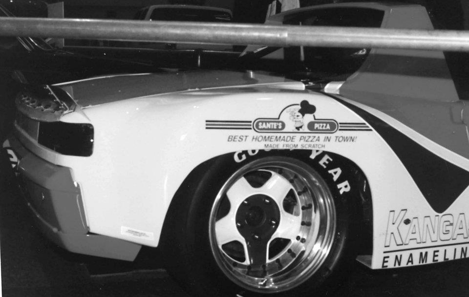

IPB Image
Group 5 Version:

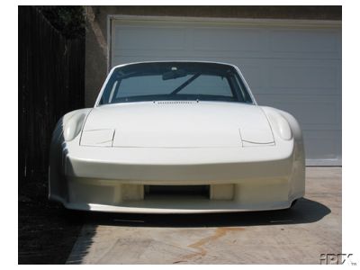

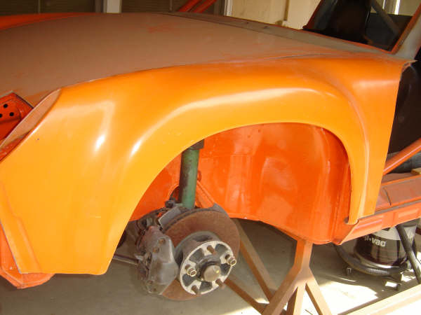

3. High Performance House (HPH)
Website: http://www.highperformancehouse.com/
Front:
Total Width: ?
Measurement off inner fender well: 14 3/4 - 15"

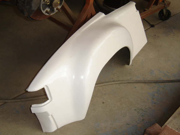

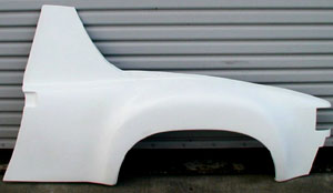

4. GT Racing
Website: http://gt-racing.com/products-page/914-parts/
Front:
Total Width: ?
Wider than stock: ?
IPB Image
Rear
Total Width: ?
Wider than stock: ?

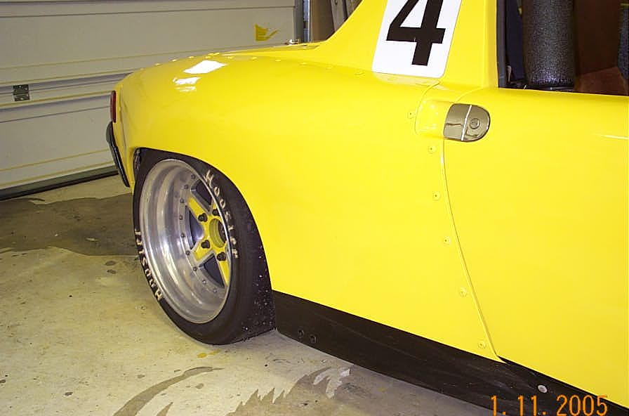

**Spoke to the guy at GT-Racing and he indicated that their rear fenders at 3" wider than a stock 914/6 GT flare.
IPB Image
IPB Image

Andyrew
My HPH fronts look around 14 3/4 - 15", I'll get the rears later as I cant really get a tape in there at the moment.
Britain Smith
Hmmmm...that means that the HPH fronts would work on my chassis. I might end up making my own set of wider HPH looking rears...we shall see.
-Britain
