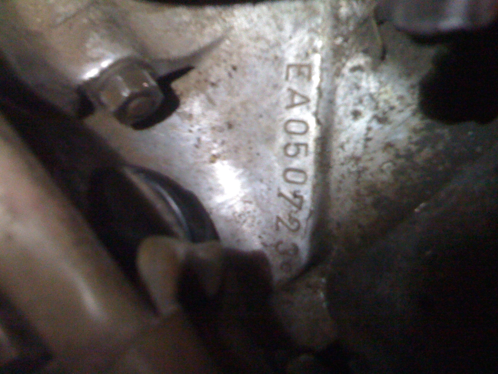

I just now realized this new engine that I have been piecing back together over the past few weeks isn’t the 1.8L that the PO said it was. The engine code on this engine is EA050723, which if I cross checked correctly is indeed a 1.7L

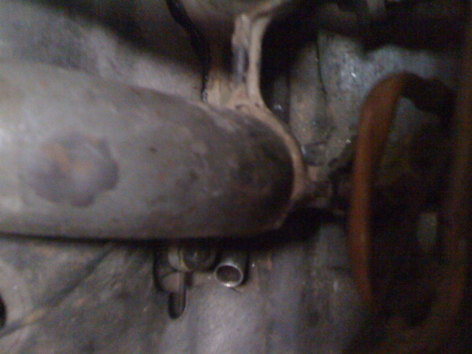

This pic shows the head vent

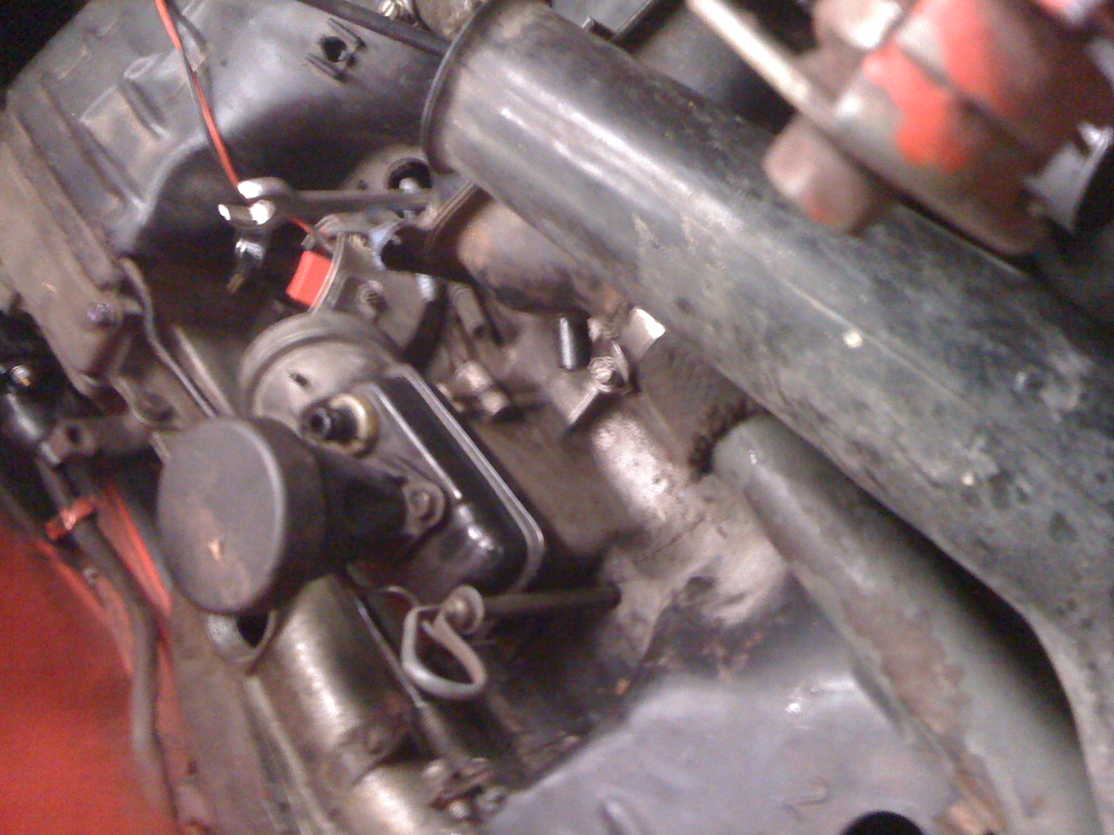

Oil filler, different set up than my old 1.8L

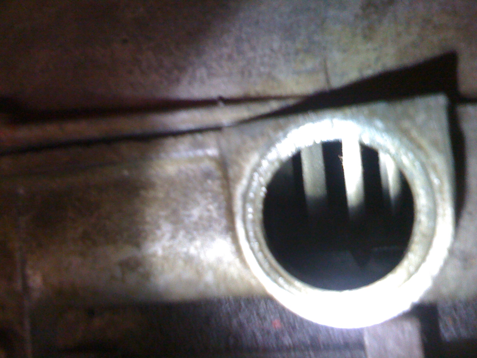

This is a bad pic, as the camera couldn't pic up the red timing mark.

Okay, this is all good news. One last thing, The head vents, can I just use vacuum rubber caps things on them? I was thinking about using them, and putting a hose clamp on it. Should I be worried about head temps melting them?
Also, was there a rubber seal/o-ring on the top of the dipstick? Seams like a good place for vacuum leaks.
Prospectfarms
QUOTE(tim_nd @ Mar 27 2012, 05:12 PM) *
Those rubber caps do seem kind of melty. You could stub short sections of hose over the vents and plug the hose with a bolt sized to match the hose.
