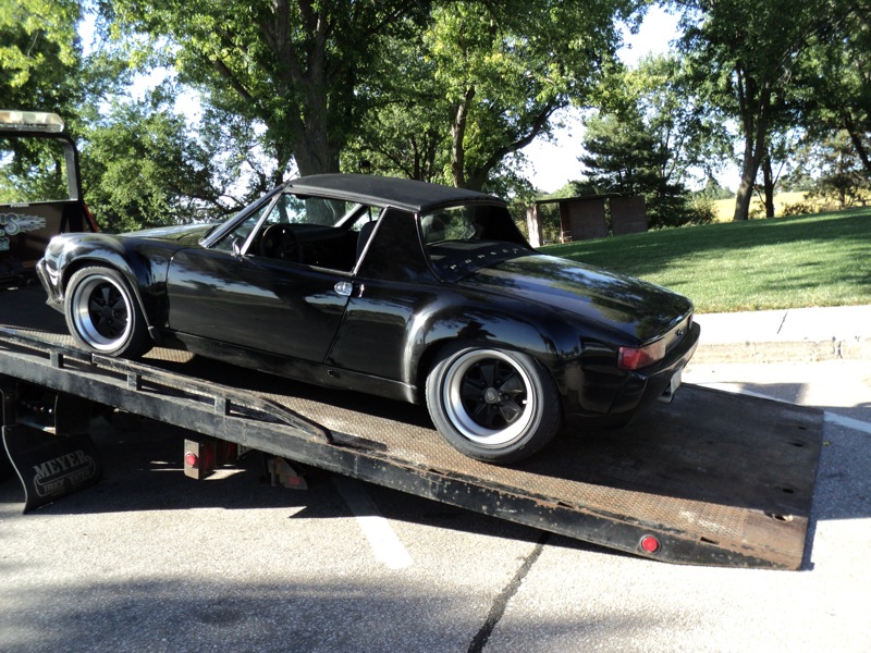

Steel flares, or fender flares in general , fit compatibly with the fiberglass, ABS rockers in order to maintain the correct line of the flare, or so I always thought??
See photo of similar car:

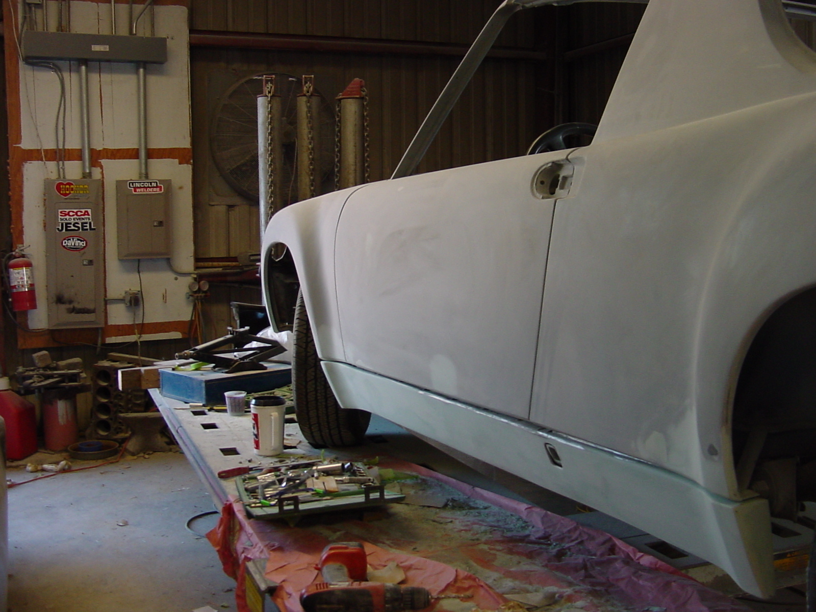

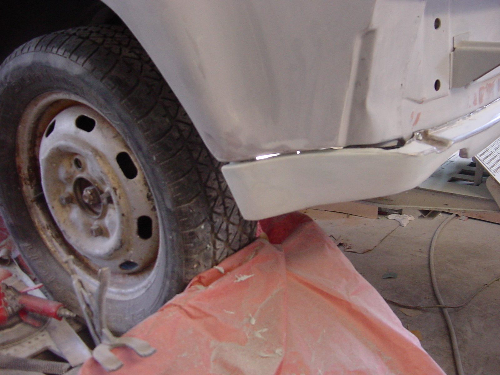

I had both my rockers and valences done when the body shop put on the flares. They look great. But there is no one that I know of who is actually doing this for sale.

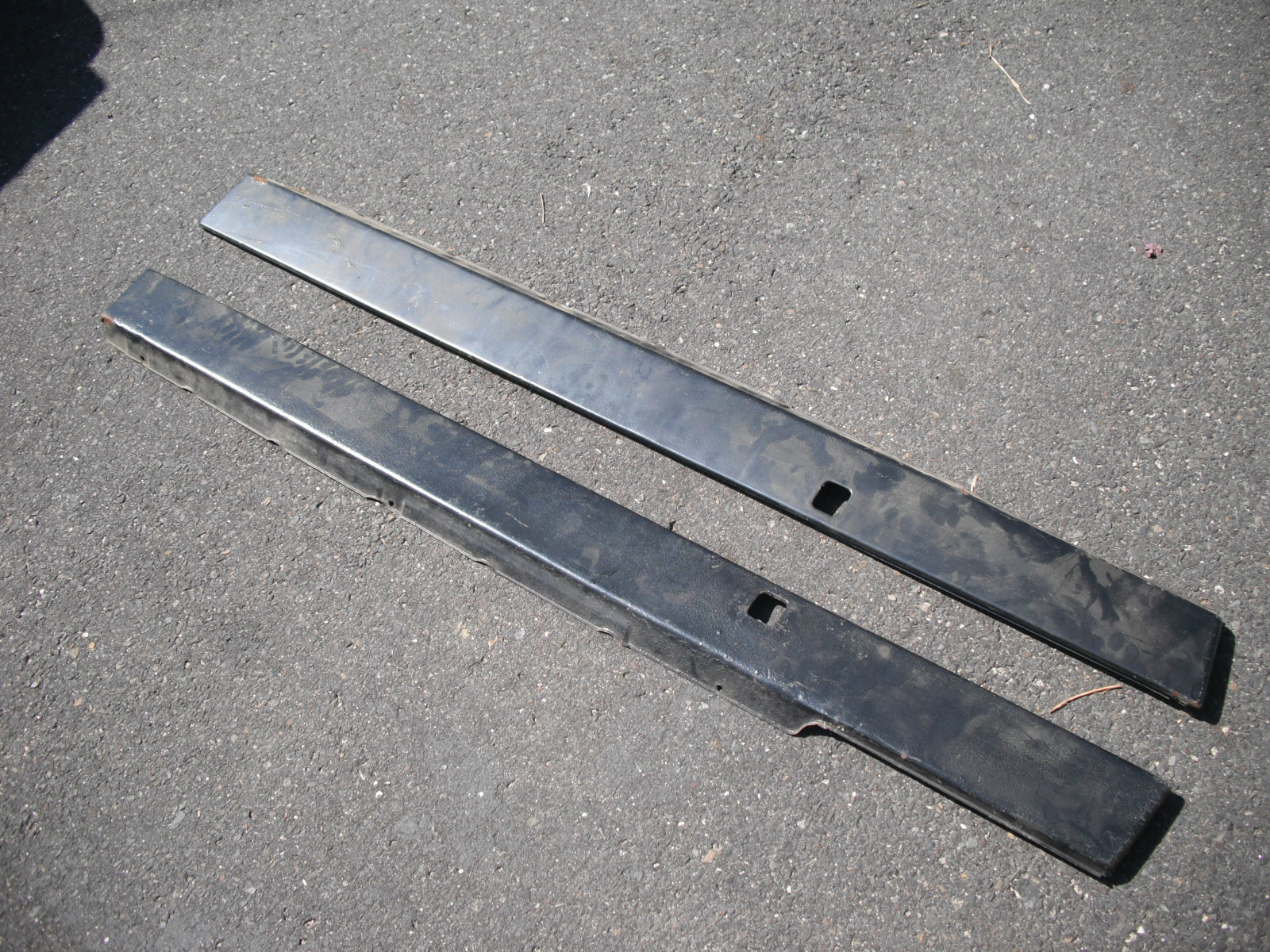

I mean the ABS rockers can be made with the exact correct roll to match the roll of the steel fender flares. The problem is that the ABS rockers tend to be flimsy as compared to the steel rockers. Does any one else find this to be at issue or is the ABS a suitable replacement for the steel and leave it as is? Yi

Here are some pictures of my car while it was at the body shop.
