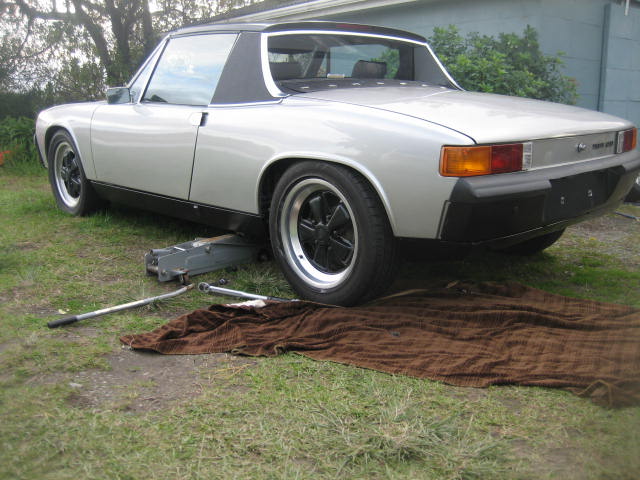

I installed a small 6 in my car yesterday and I noticed the car has more positive camber to the rear wheels than before the conversion. Is there an adjustment for camber? Ive yet to put on the axels, might that straighten it out?

Check Chris Foley's site. He has Camber adjustment shims. I bought two sets to straighten mine out. You will need to get longer bolts too. wait until you get it rolling and bring it into an alignment shop.

You remove shims to create negitive camber.

Just the axles won't affect the camber. Putting weight on the wheels will.
The camber is changed by adding or removing shims between the outer trailing arm mount and the body. More shims mean more positive camber, less shimming (fewer or thinner shims) mean more negative camber.

Just to be clear, if the top of the tire tips in; that's an indication of positive camber?

Nope, thats negative camber.
Positive is like old vw baja bugs... (top of the tire, leans outward)

Great info, much appreciated! Last thing, should the car be set up neutral or biased positive or negative? I've got new shims but want to get it close so I can drive it to get it aligned.

It depends. If you are driving for street and longevity of tires, set it neutral. If you care less about the tires and want an aggressive street / AX / track stance, set it up for negative camber. On street and track I prefer the latter.

I would advise against a neutral or positive setup, even for a street driven car.
Our cars benefit from negative camber.
The max. you can get out of the stock setup is about -2 deg. in the rear. That would be running without any shims. However, for most street driven cars, this is too much.
I think the sweet spot for a street setup is somewhere between -0.5 and -1 degrees.
