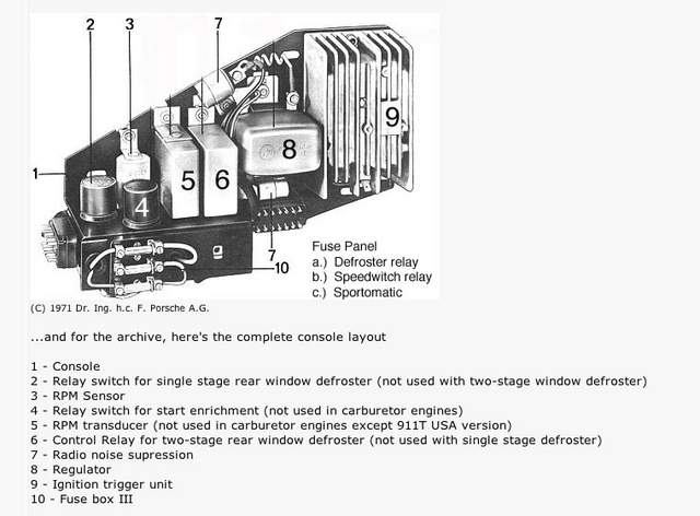

There is also a relay for the cold start injection contraption in the 911 engine relay panel. I promise you the car will not start easily if the cold start injection is missing or disabled. I removed this panel from my '72 911 when I did my 3.2 swap, but if I were ever to put a 2.4 MFI motor into a car I would definitely want to keep it. You are going to need the external voltage regulator, 3 pin CD box, and all of the little MFI bits either accounted for and in good working order, or properly substituted for with things like the Supertech kit. Adjusting the MFI in a 914 is really going to be tough, too, which is probably why the factory used carbs on the -6. Here's the 2.4 MFI 911 relay panel for reference.

ClayPerrine
QUOTE(shuie @ Apr 13 2012, 10:44 PM) *
Acutally, from experience, it is much easier. You can get to the pump, and you don't have to go through the fan. Just a short, small flathead screwdriver.
