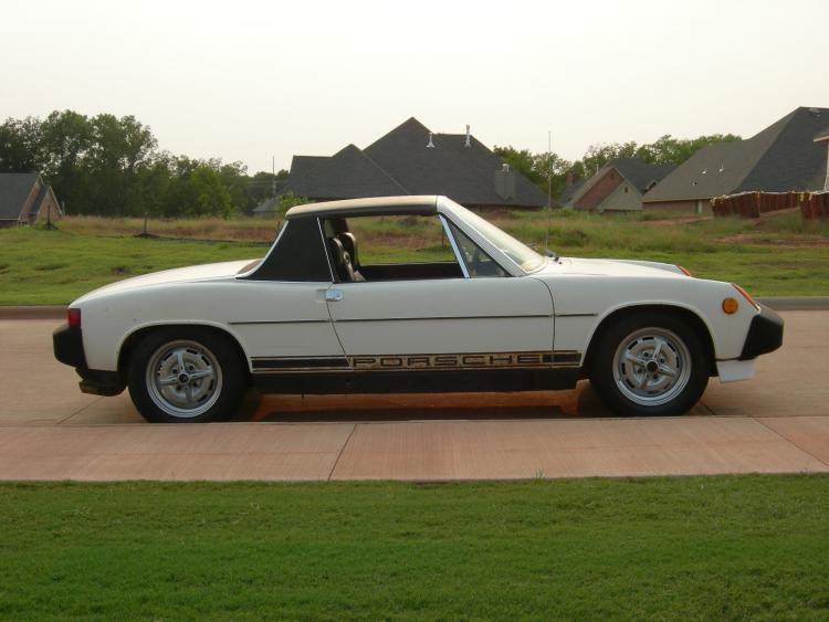

This is the car at its PO's place before I got it:

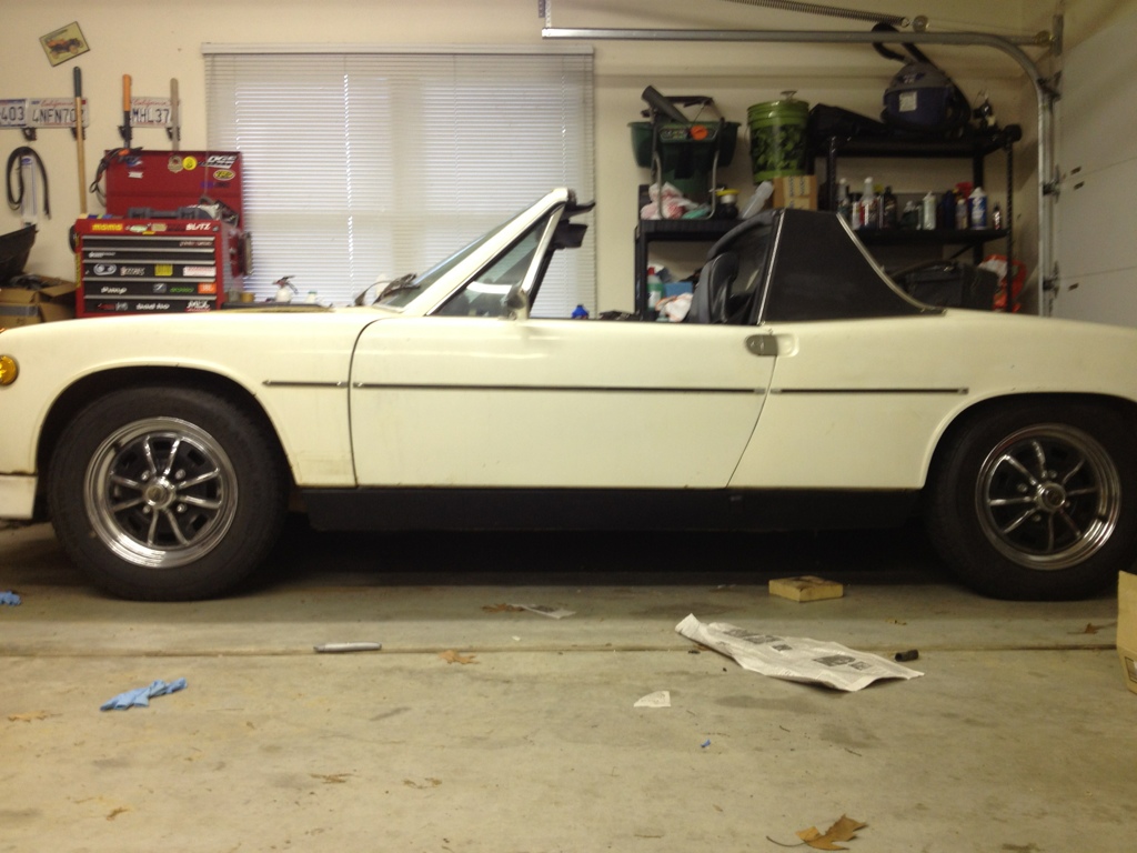

This is how it currently sits:

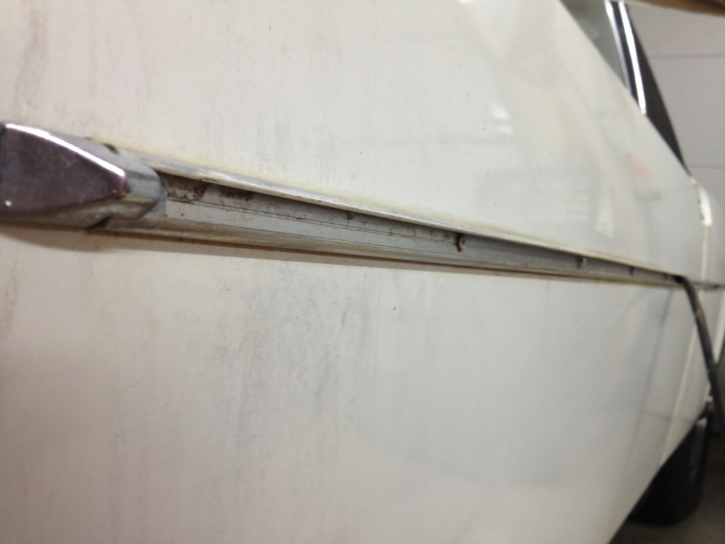

not gonna be painless. They were mounted using rivets.

How they were mounted varies from dealership and car. Look on the inside of the rear fenderwell to see if there are rivets... Some were put on with adhesive - Either way may be painful, as the adhesive could pull paint off the car as well -

I had a 1974 Mazda RX4 with the same trim. If it was mounted correctly there will be rivets holding the end tips in the aluminum channel molding. The Urethane insert comes out pretty easily but the Channel is usually riveted on both ends and then the long one will have it every 12" or so.
I also worked at a place for over a year selling this stuff. Installers used to buy this stuff in bulk and just drive around to dealerships installing them for maybe 20 to 50 a car depending on how much molding per car. Real easy to install as you only need a small drill, rivets, masking tape to hold in place and the insert.

Some of the rivets are making their way out.

If properly installed, I would just ignore it. This addition was very common back then. I think it looks just fine in a period correct sort of way. The trim appears to be straight & tight. Any rust near the rivets?

I have seen some of the rivets on the driver's door are starting pull out a bit. No rust around the rivets
