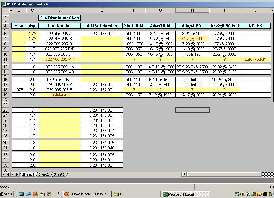

Found this chart here, during a search for the info I was originally looking for when I posted this thread:
rhodyguy
May 27 2012, 09:52 AM
wow!! cool chart. i don't know where you found it but it should be in the 'originality forum' if not already there. the AA and AB have the same specs. i wonder if the dif is being for a 74' L-jet system vs 75-76'.

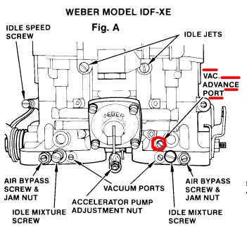

Weird. I checked mine (Spanish made 40's) and it was there on both, here:

i just looked at some italian 40s. screws are there. you learn something new everyday, hopefully. this is turning into a very informative thread.

Only question now is one of confirming the PN. The number on my 1.8 dizzy is slightly different from the one in the table; it's stamped 021 905 2305A-B. The secondary number is the same as shown in the table, so I guess it's the same 1.8 dizzy, correct?
