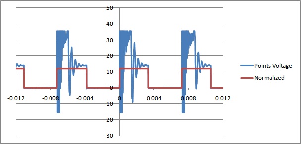

Valy
I had the same problem in the past.
I took a plot of the points voltage with my scope.
The blue line is the actual voltage on the points and the red one is what you would like it to look like.
The biggest problem is that the negative spikes near the pulse middle cause the tach to believe the engine is spinning faster than it realy does. Some spikes are dumped by the tach filtering circuit but some are too big for it to handle so you see the tach jumping up.
