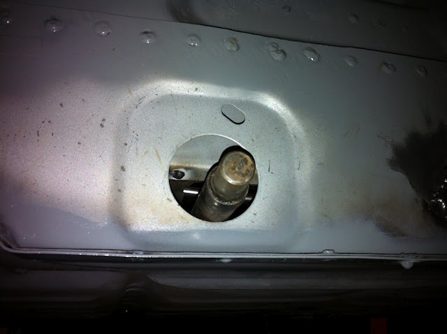

What's the best way to finish this? I cannot find the stock flange for the SS bushing anywhere. I have all of the proper SS conversion parts. I also bought an aftermarket bushing, but it's going to need some kind of adapter plate and additional work to fit and function properly with the stock parts. I even kept the old tailshift bushing flange from the original firewall thinking I may mount it to a plate and then sleeve the sideshift rod to work with a tailshift bushing. Im stuck. I need to rethink this entirely and figure out something that is going to work. All options are on the table. How would you finish this if it was your car?

I believe that Pelican sells a bushing for early cars that have been converted to SS. However, if it were my car, I would see if there is anybody out there with a parts car that has the factory SS flange.
McMark
I have a car I can cut that from.

Well, that was easy smile.gif I'll take it! Where do I send funds?
