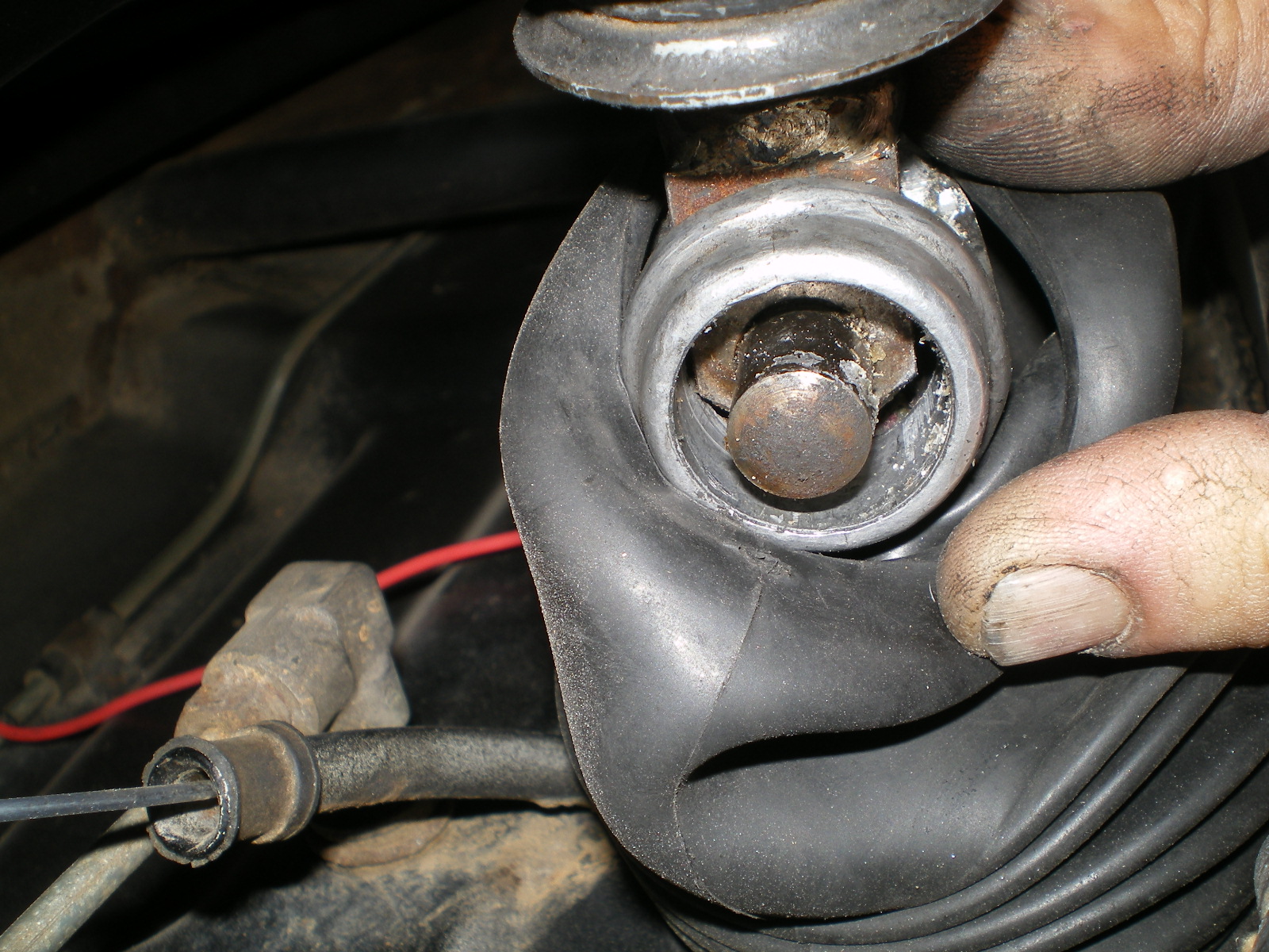

I mis-aligned my 12 pin connector on the relay board (less than a week after reading where Andy did this same thing) and burned up my Pertronix. sad.gif This lead to re-installing points and condenser barf.gif . For the life of me, I could not locate my timing mark when setting the timing. Verified TDC and repainted that mark thinking it might be more visible. Another 30-45 minutes of wasted time before I realized that I couldn't time off the #2 plug wire. headbang.gif headbang.gif headbang.gif Feeling remarkably confident, if not challenged, I moved on to adjusting my shifter. I noticed that 5th had become a challenge when in AZ (it had been on jack stands awaiting parts since) so I decided an adjustment was in order. I spent the next 1.5 hours "chasing" the correct shift pattern before I looked behind the rubber boot and found this. I was chasing my ass. Feeling stupid is easy. biggrin.gif

That coupler bushing looks just like what mine did several years ago.

I need to change those bushings as well...how are those changed?

I have an extra set of those bushings. I will express mail them tomorrow for FREE! if you want them.

I ordered some from GPR Saturday so they'll probably be here by the time I finish this reply. lol-2.gif

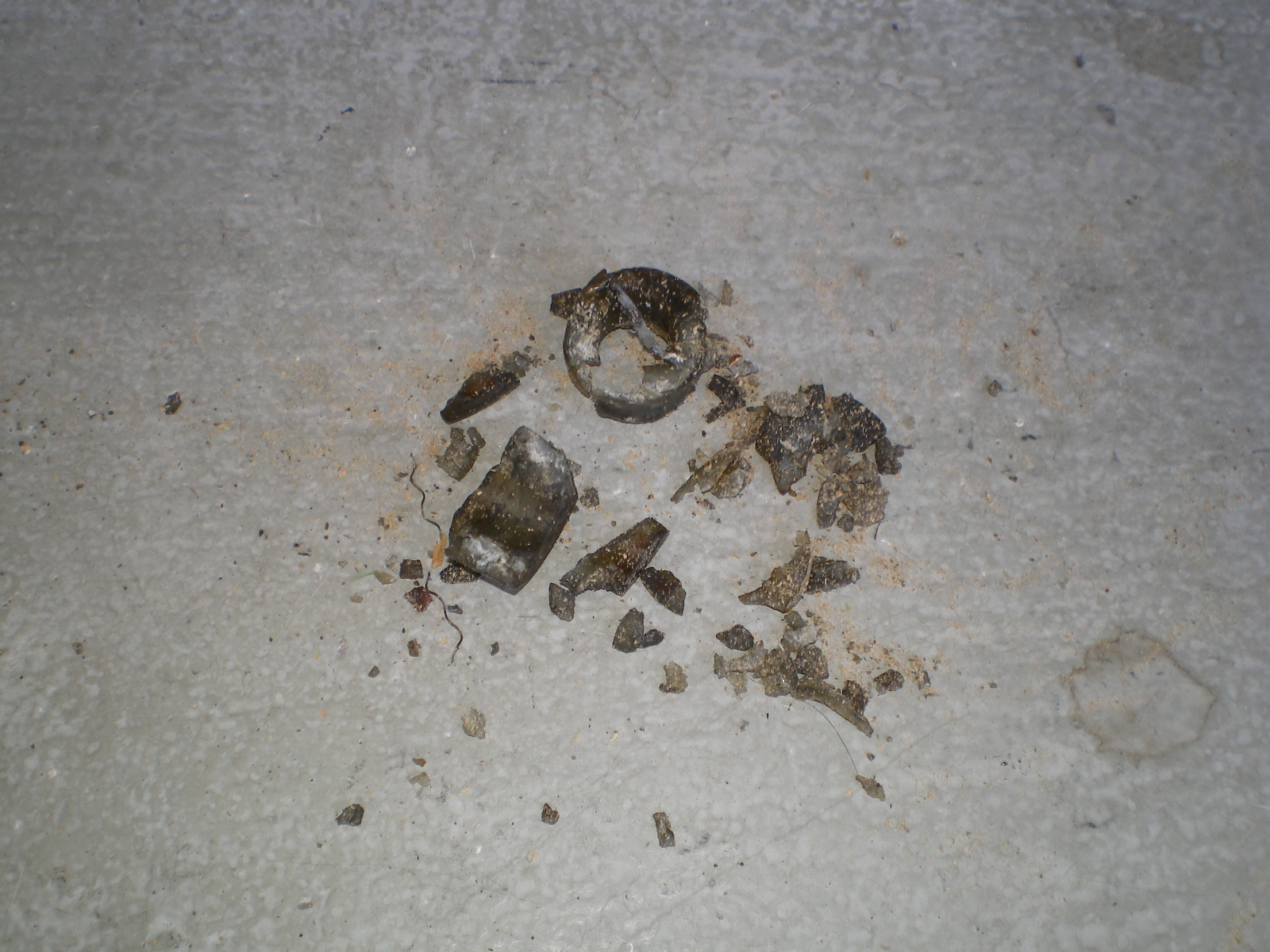

Now for the rest of the story. I busted the bushing; I think. As I was setting dwell I was bumping the car in 1st to bring the dizzy around when it popped out of gear (I wonder why?). My drive has a 12% incline popcorn[1].gif . I grabbed the psg sail panel and quickly realized I could not get around to the drivers side before it was down the street. So, I jumped in the psg side only to see the wheel lock in place and we were headed to the right with my pickup bed looming in the near future. I pushed the wheel as far left as it would allow with lock while trying to slam into a gear; any gear. I saw that I was going to miss the truck but I needed to close the psg door to do so. My big f*&%ing foot was stuck in the door and I had to force the door closed as far as possible to miss it. OUCH! I'm pretty sure one bushing was toast and I burned the other one in my shit fit. The neighbors were entertained with my vernacular.

Press out the pin in the middle, take the joint apart, put new bushings in, put the joint together, press the pin in again. Be careful to support the housing carefully, it is easy to crack.
