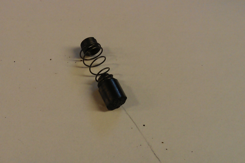

Finally I found the reason: the "coal pin" in the middle of the distribudor cap had broken, when I took the cap off the broken end fell out, after fitting a new cap the car runs great again. Strange however that it only ran bad at cold engine...not at warm...
You never stop learning!
IPB Image
/Lars S
