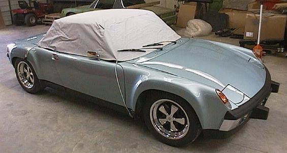

Could you explain what a 914 umbrella is or show a pic
seanery
914 Umbrella
Perry makes these 9146986 here in the world.
Here ya go: This is a good link
IPB Image
rstover
QUOTE(seanery @ Aug 30 2012, 08:12 PM) *
914 Umbrella
IPB Image
Thank you
mrbubblehead
i use my umbrella daily.

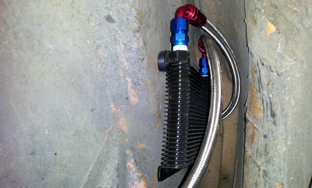

gothspeed
QUOTE(pcar916 @ Aug 30 2012, 09:15 AM) *
I totally agree that oil cooler(s) in the engine compartment are not a good idea, especially since there is a ton of unutilized space in front of your right rear tire.
+914 beerchug.gif .............that is exaclty where I am gonna put my extra oil cooler .......... maybe put a fan and some 1/4" screen to protect from rocks ............ that is the factory oil cooler location of the 930S .... smile.gif

JmuRiz
That fender-well cooler is neat, hadn't thought about that location.
