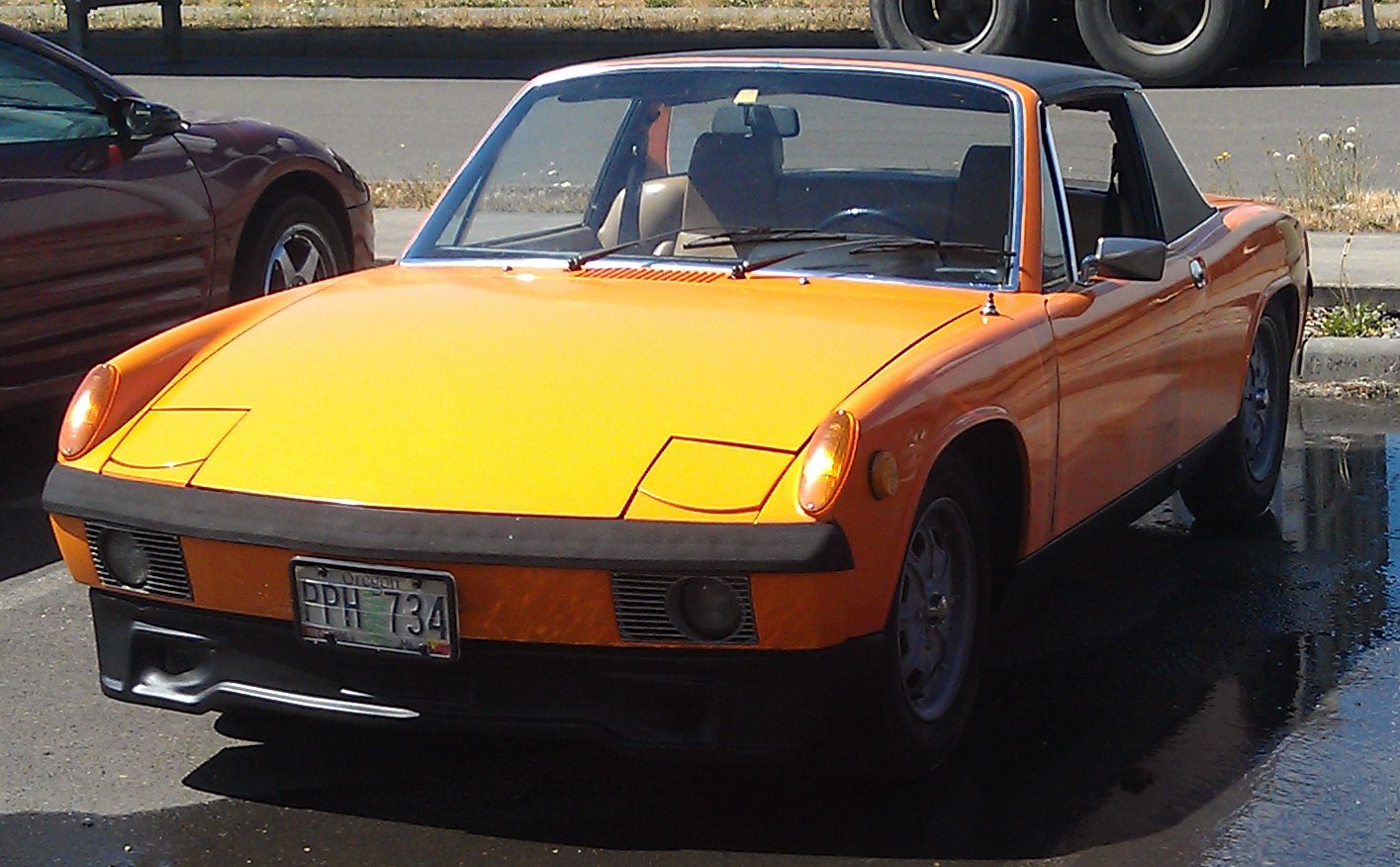

Right after the MPS stopped working I found a good deal on another nice '74 2.0 FI 914. It has a factory MPS correct PN 0280 100 043 and runs perfectly.

I have included a picture of the new car in hopes there are others like me that like pictures. I only open threads with pictures as I cannot read good (well )just joking). Maybe other people can relate to this.
