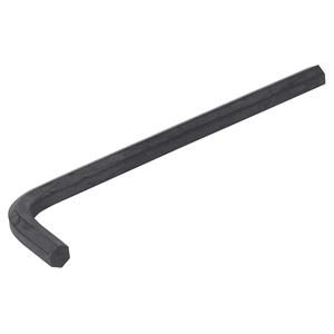

One is just a big 17mm Allen wrench. Most FLAPS or aftermarket VW parts houses carry these

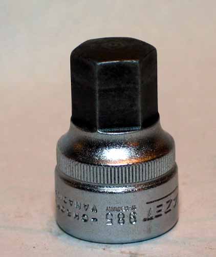

Click to view attachmentThe other is a 1/2" drive ratchet/breaker bar attachment (Hazet, Proto, Sears, Snap-On, etc.)
