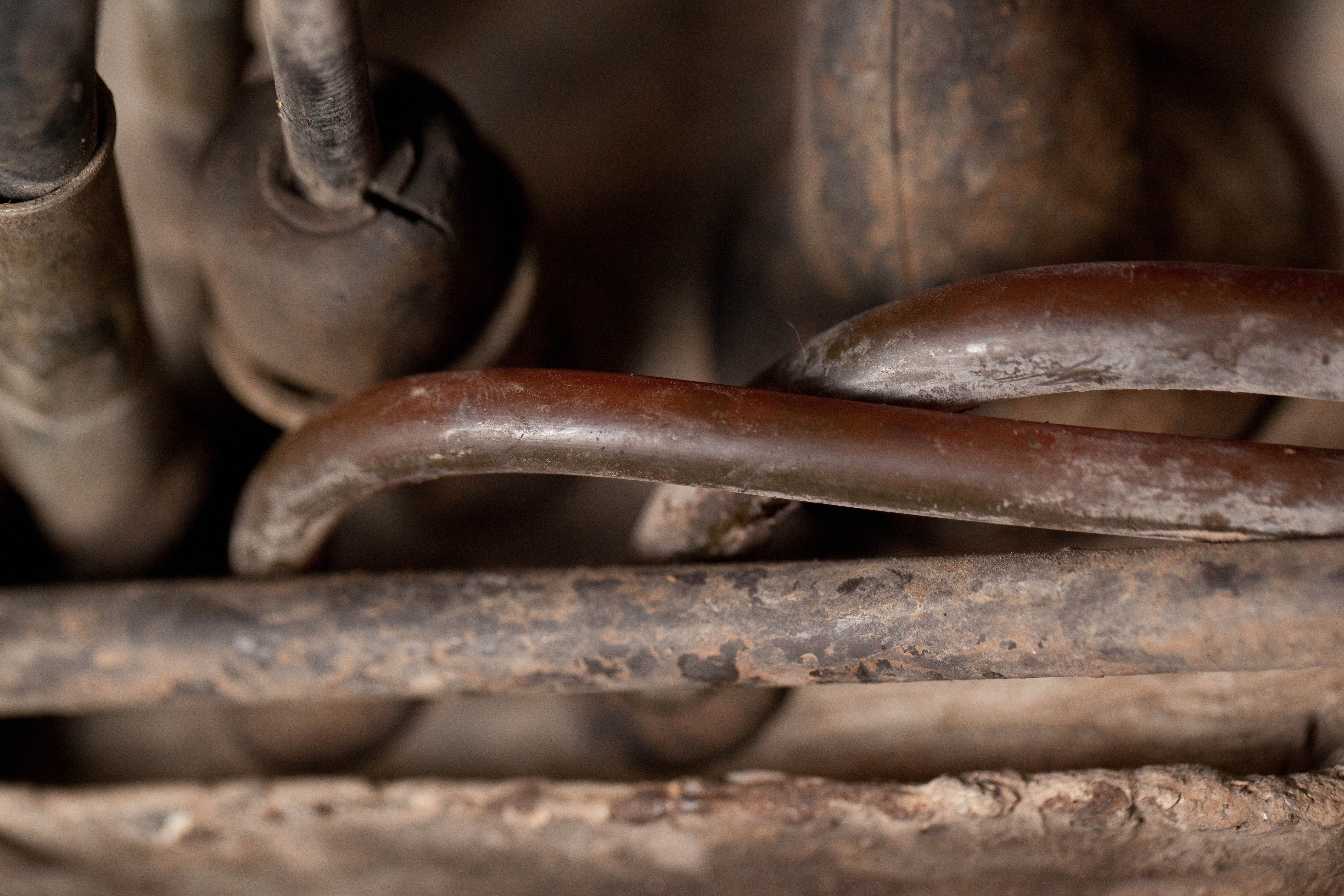

That being said, I have a question that has stumped me a bit. As I have been investigating my car, I found that the fuel line ports that extend into the front of the car under the gast tank are SS. At the tunnel inspection point I can tell they are SS as well. But at the firewall where they exit the tunnel, the lines are plastic. I have found a few vendors that sell the SS lines and they all seem to be SS all the way out of the tunnel into the engine bay.
I am at work now and only have a pic of the lines into the engine bay. I will post others of the front bay under the tank and the view from the tunnel this evening.

i just removed mine today - and i can tell you - to my surprise - that the front 18 inches or so is metal and the back 3 foot section is plastic.

The line shown is the stock one. Metal up front, plastic through most of the tunnel and under the engine bay.

Sounds and looks like factory original lines. Get rid of them.
