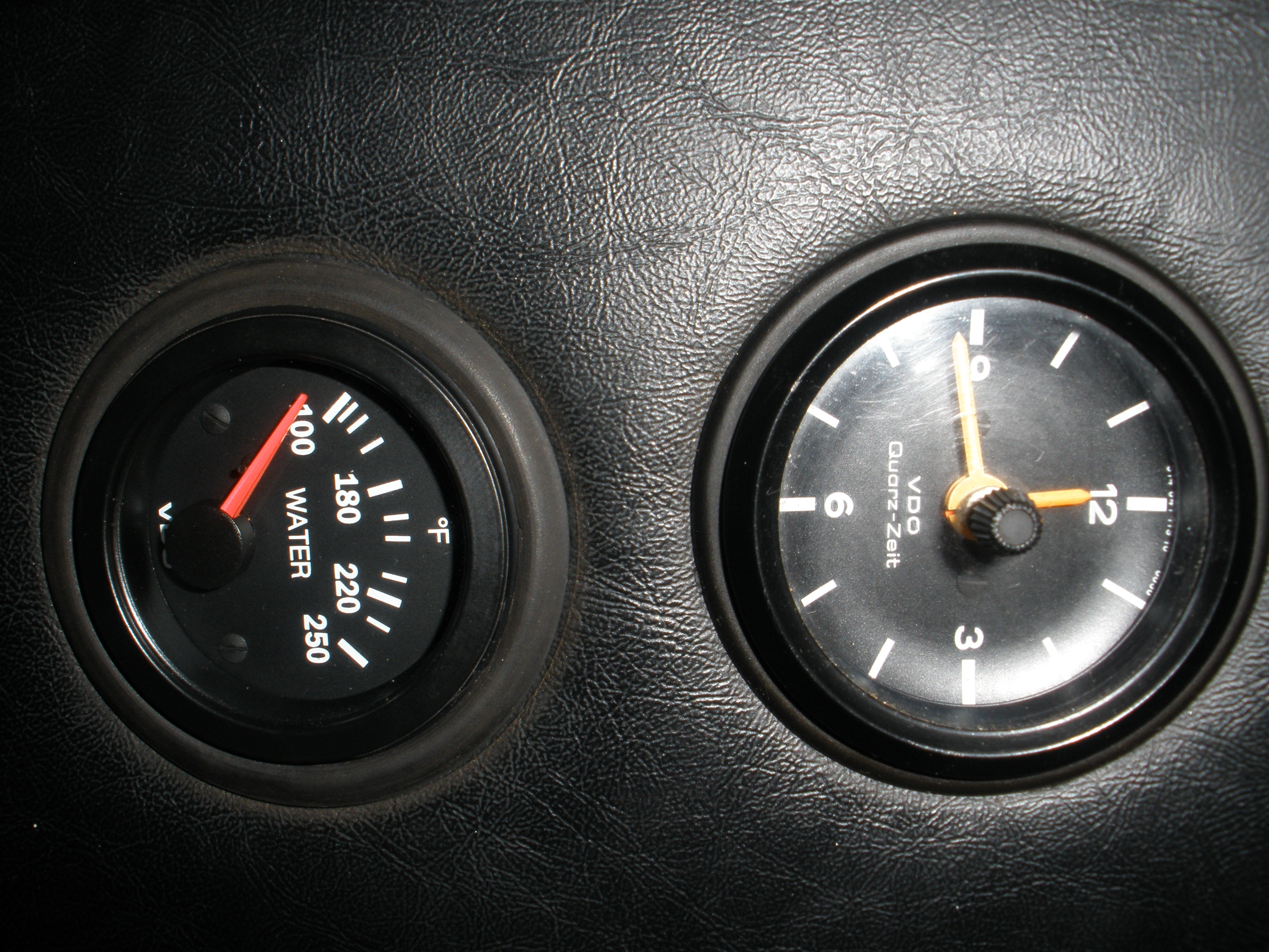

Yes.The way I did mine:
Go to Eguages or an equivalent.Buy the correct sender for your LS(VDO style)
I used the 120 deg sender,and bought the vdo temp guage (part#310-105)
Wiring is dead simple. The stock plug fits perfectly.You have to swap 2 wires in the stock plug,the power and the sending leads.Thats it for the stock plug.The back light requires a ground(cause the new vdo has a plastic housing)I ran a ground lead to the nearest under dash location(Stock bolt) and done.
Almost.
The guage is smaller than the ones in your console.The guage has a threaded plastic ring that is used to seat the guage up against the mounting hole.This helps with the diameter problem.Spin it on.Now the guage is closer to stock diameter.The rubber mount you pulled off your stock temp guage is useful here.
I tried to use it as is.Not a great fit.Take it and flip it inside-out.Viola!The whole assembly fits nice,and trims the guage face/retainer nicely.
And its tight as the rest. Needle is wrong color(or have the old ones faded confused24.gif )but its not noticable while driving.It keeps temp perfectly.I have confirmed this with a temp gun repeatedly. smile.gif
Its a nice solution.It also(with a minor modification)fits the stock harness and location,and doesnt look out of place.
It comes with 2 filters for the backlight.The green one is perfect.

Thanks for posting. That's a nice solution, but I think I want to retain the stock gauge. On the advice of previous poster, I went to the Hollywood Speedometer site, and I think they can do what I want. I'm gonna get the reading of the sensor in ohms when the first fan kicks on, supply them with that info, and have them adjust the gauge to read 2/3rds at that point. They can re-do the face to add acutal temps, but I'm fine without that.
The gauge works fine as is; it's just hard psychologically to have the needle so near the red when it's at normal operating temp.
