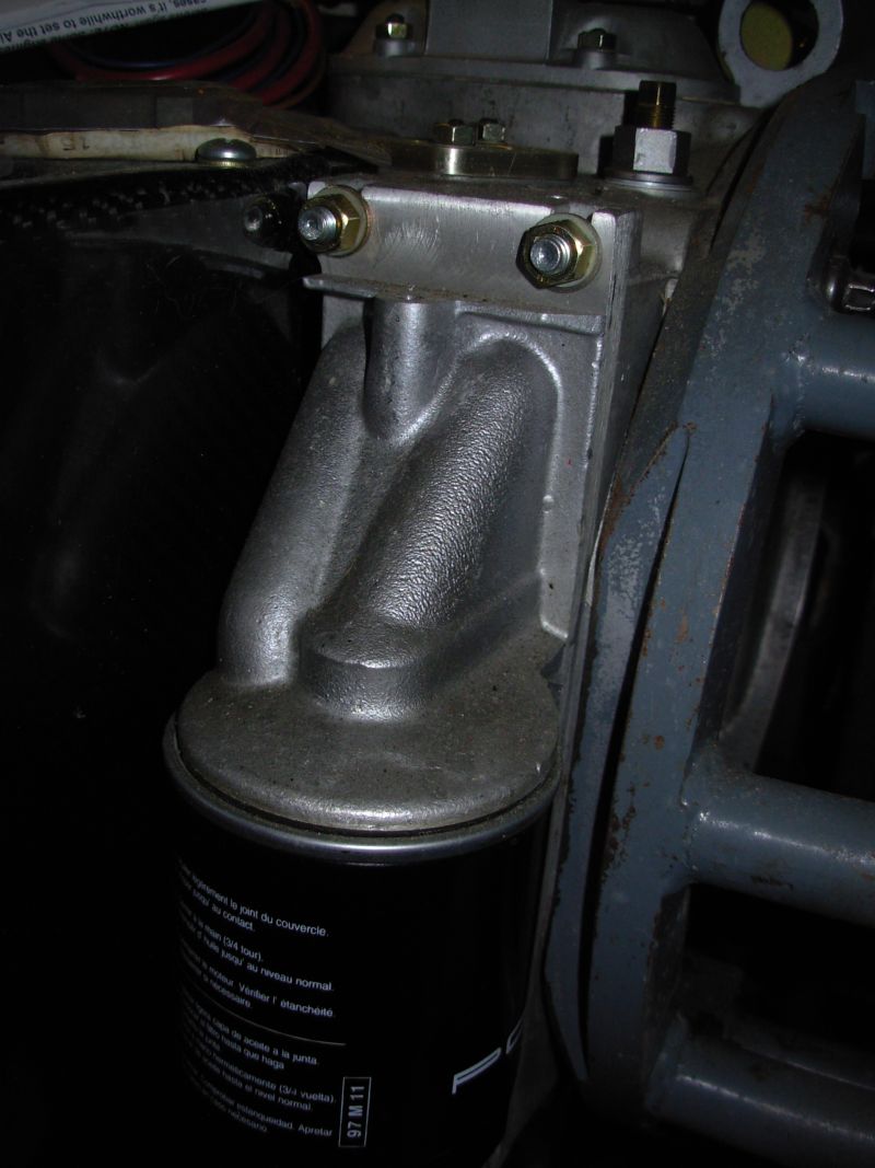

Here is a Porsche by-pass part ( I believe it is a 993 Part # and will work on earlier motors down to 2 liters) & it encompasses an Oil Filter Housing
QUOTE(carr914 @ Sep 26 2012, 01:46 PM) *
TC - Thanks for pic. I've seen the part and I think they run ~$450. The aircooled racing part is $160 and does not include an oil filter mount.
