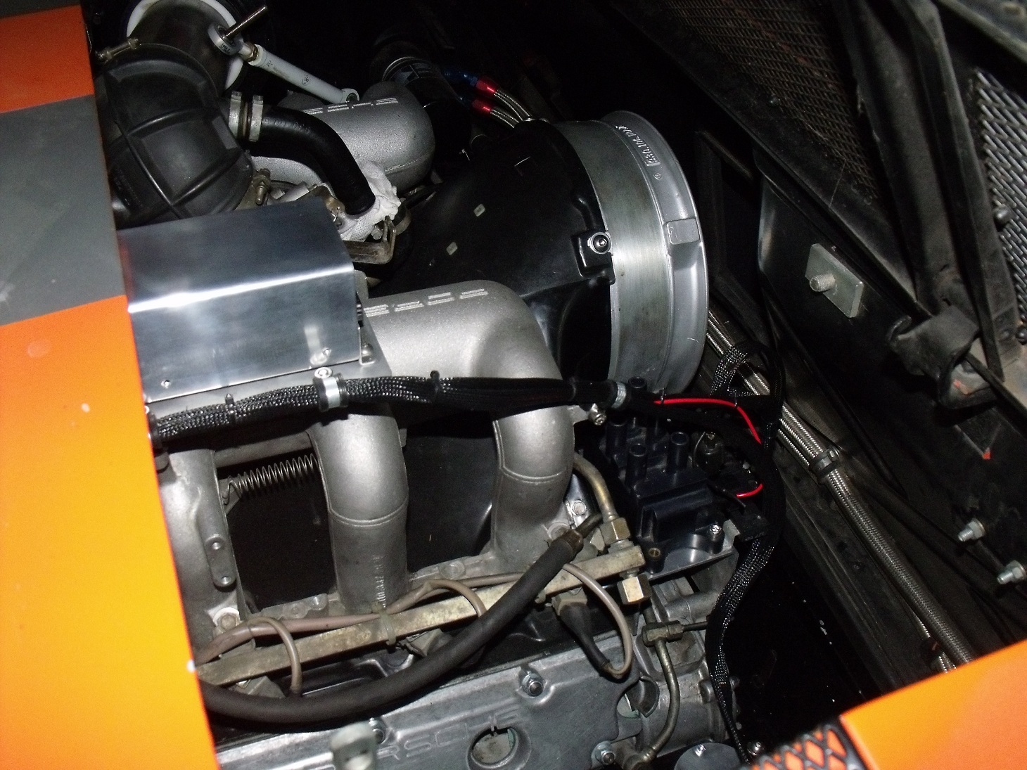

erwan914
my car 3.2l gearbox 915 fuel injection megasquirt
IPB Image
