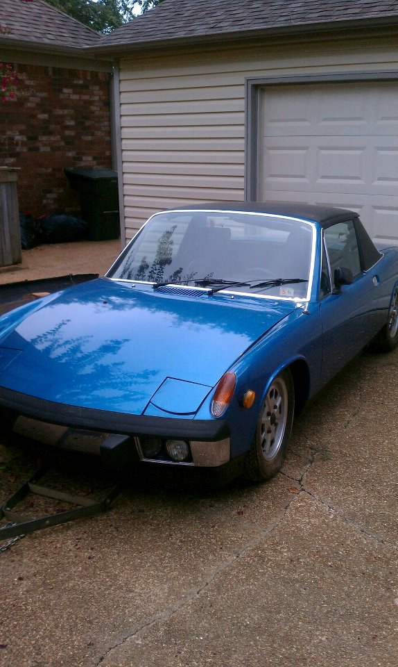

Okay, I am tired of trying to find what I am looking for in the old threads. I need new tires for Betsy and I run 205/50/15 on my other teeners. I am afraid this will have her sitting too low for the towbar brackets that I have drug a few times already with 195/60/15s. Front struts are shot and bottomed out so new struts will probably stop that but I want a wider tire without going too low profile. I have decided to just keep her as a street driver and no ax so what say the masses? Which tire size would you suggest? confused24.gif

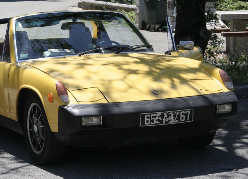

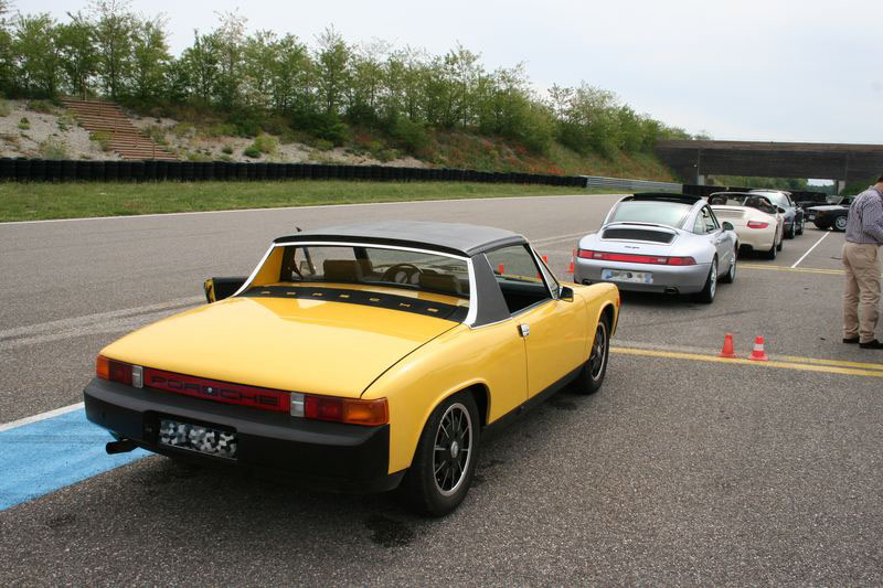

johannes
As I wrote earlier 185/65 is very popular. The size with the largest offer and the one you will have the cheapest tires.
On theese pictures you can see how they look on the car.
195/65 would be my second choice. They are larger but you won't find all tires in this size
IPB Image
IPB Image
