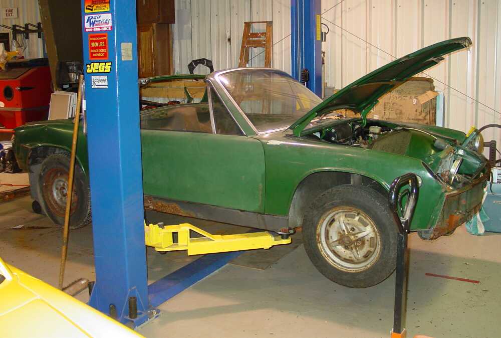

I have an amazing story to tell all of you!
Several weeks ago I was visiting Garold and helping him chop up a couple parts cars.
Garold had just pulled most of the useful parts off of a plain Jane 1971 914/4 it was an irish green car with no options not even the roll bar vinyl.
I am working on a couple projects and need some sheet metal parts so I asked Garold if I could grab the car from him when he had picked it’s bones clean… Garold agreed.
Garold being the generous soul that he is called and said he would bring the car to me!
We rolled the car into Kinnaman’s shop and I noticed the engine was still in the car, Garold said he didn’t have the time to pull it, he said go ahead and take the engine and transmission…it is a tail-shifter anyway.

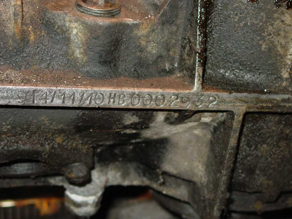

gms
I kept moving the engine and transmission assembly around when I noticed that it was a 1971 transmission with a clutch hoop on the side cover…that is weird they stopped that in 1970?
I notice a small aluminum tag on the “SD Oil Shell 1747A”

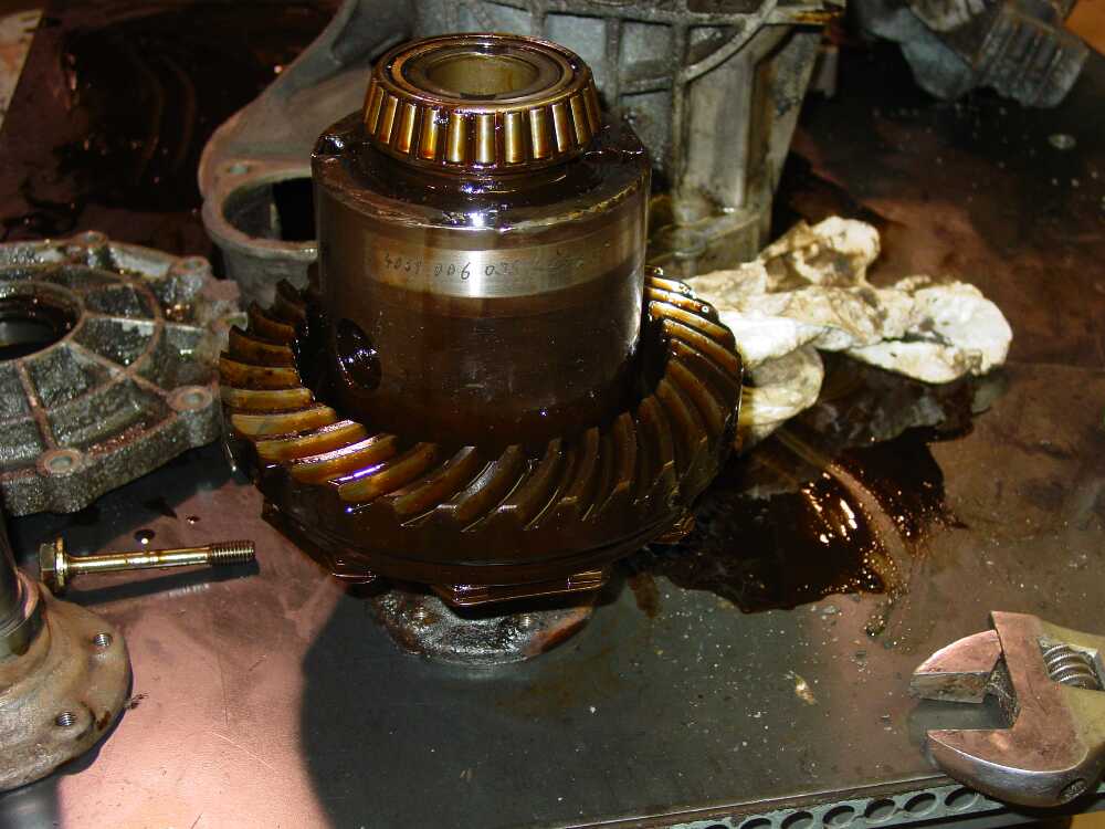

gms
I turned the output flanges and I could not believe it, this trans has and LSD!
A no option 4 cylinder with an LSD what are the chances. Garold you are a lucky man!
gms
I am going to pull it apart and see if it has special gears or a 904 mainshaft.
stay tuned for more pix and numbers

gms
it has a standards "F" 2nd gear
A couple more pictures

Bonus! Yup, HB on the part number is a factory LSD. Very cool. I wonder what R&P it has idea.gif

Hammy
Is body salvageable?
GaroldShaffer
QUOTE(Hammy @ Oct 29 2012, 10:49 PM) *
I would say yes. It's Glenn's car now. There has been some talk of making it a racer or?????

Bartlett 914
QUOTE(Hammy @ Oct 30 2012, 01:49 AM) *
The body is amazingly good. Rust through the front trunk seal area. Right rear quarter is damaged and a few dents. Really too nice to cut up.

gms
QUOTE(ConeDodger @ Oct 30 2012, 09:35 AM) *
Transmission might be from an earlier 914-6?
Rob, the case is a 914/11/10 which is a tail shifter 4

Richard Casto
Thanks for sharing Glenn. It is nice to see photos of the tag and the stamping on the case.
Richard
Glenn
The rear shifter has the Shell SD ( spurr diff ) tag at 11oclock on a diff cover stud.
On the bottom spline of the trans is 914 / 11 / 10 HB 001 7521 I don't know the VIN of the original car but the trans has the early intermediate plate drilled for the throttle bellcrank but does not have the cable loop on the diff cover. I guess it is possible that it could be a 6 trans with a 4 rear cover. It will soon have a 6 rear cover.
The side shifter has no distinguishing features but does have the Shell diff. lube. tag in the same location. The only identification on the bottom spline is HB 15 11 2
There is no evidence of tampering or grinding on either side of these characters.
I don't have any info on the VIN of the original car. I suspect it could be from a '73 2.0 that I purchased in parts. When time permits I'll look for casting date codes.
Hope this info is helpful.
Rory
Thanks Rory, this is interesting information

Hi Glenn, the number on my 'box' is 914/11/10 HB0020030, it also has the Shell 1747A oil tag.
Dr Evil
The shell tag depicts the type of oil with the particular LSD additive in it, and the HB indicates factory installed LSD.
