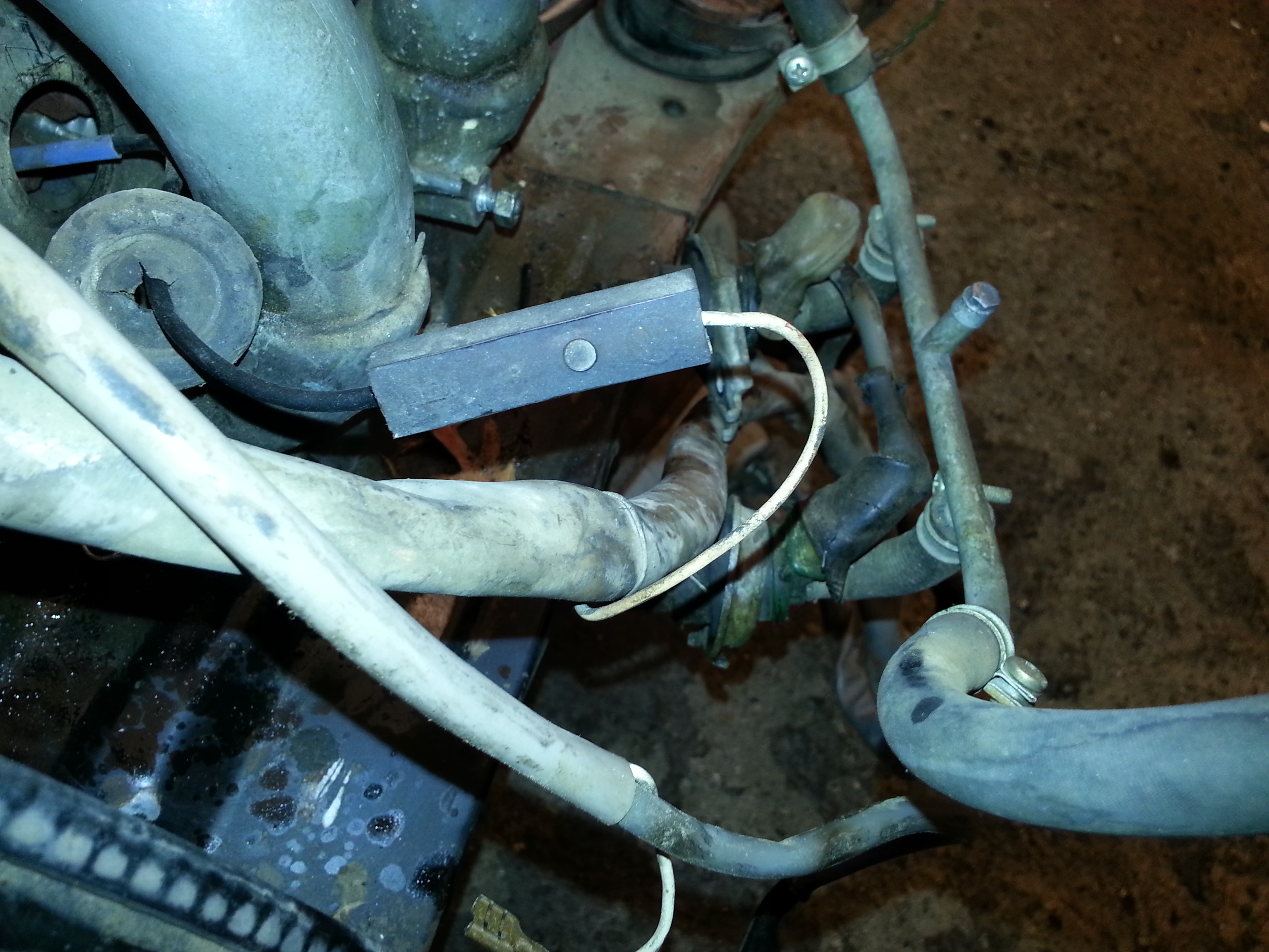

Can I just pull on this to remove?Click to view attachment

Yes, Just separating...this is what I have...and thanks for you replay...
'73-914kid
The white wire on the harness has the plastic clip molded around it. unplug the black wire, from the plastic surround. Just do it carefully... that harness is in amazingly good shape Jaime. Looks like you've gotten a lot done on it so far. Looking forward to resealing it smile.gif

QUOTE('73-914kid @ Nov 1 2012, 02:29 PM) *
Not quite. Both the male and female plug ends pull out of the insulator. Is not"molded" to the wire end.
