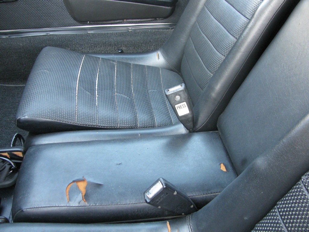

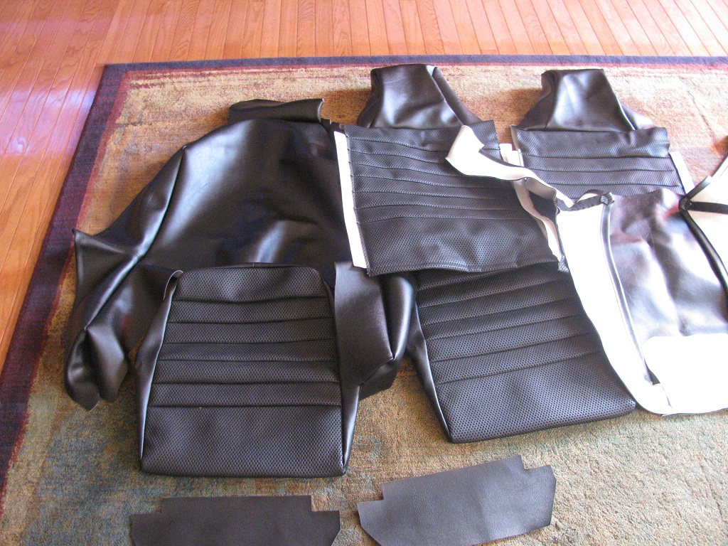

I wanted to put together a little overview of my experience in Seat Upholstery.

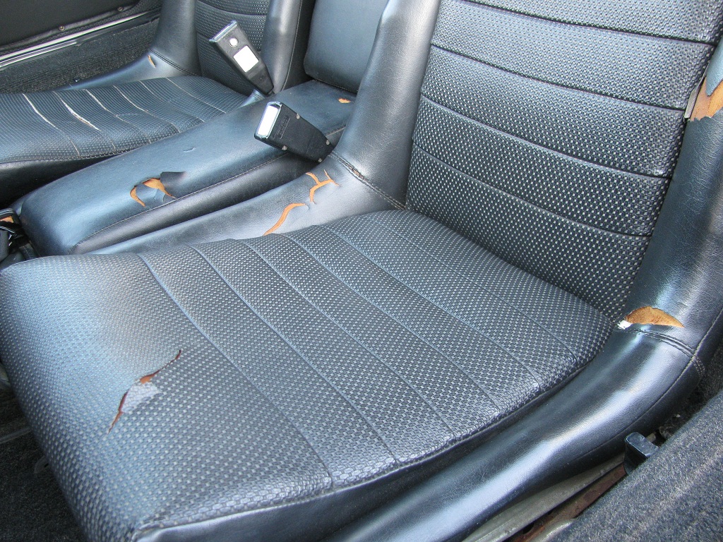

I started with some very brittle and ripped seat and center cushion.
I purchased my seat upholstery on ebay, but there are several vendors.

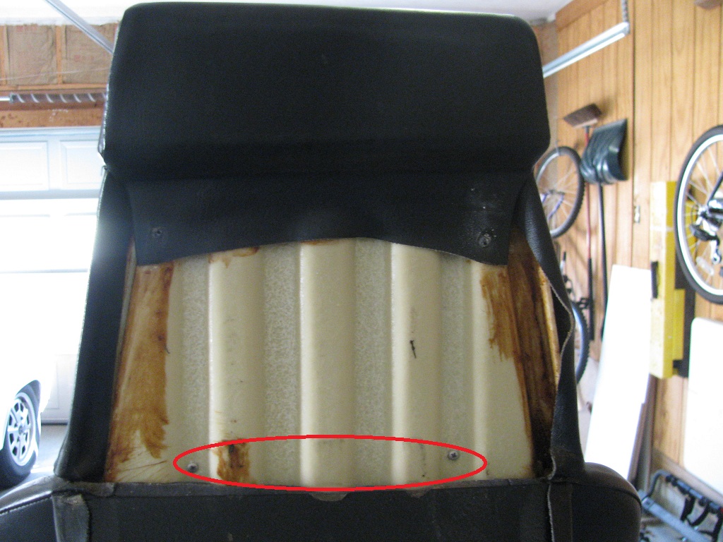

Remove your seat, I did one at a time, in case I wanted to refer to the other seat to see how something was done. The first step is to remove the two screws on the back of the headrest

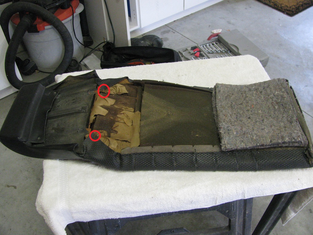

Then the two screws in red behind the headrest flap

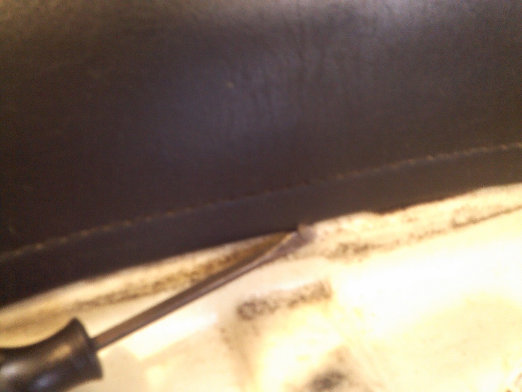

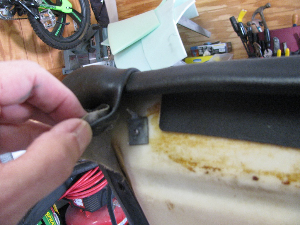

There are three metal points at the base of the back rest that need to pry'ed up with a flat screwdriver and pliers to release the bottom of the backrest
Here's the backrest removed, and you can see what it consists of on the back. On my car the headrest cover came off quite easy.
Next you can see the points that hold the side bolsters on, these need to pryed up and straightened as well

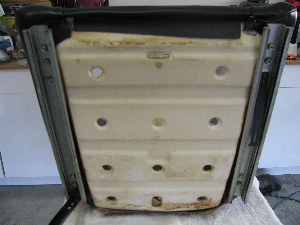

But first, you need to remove the seat rails by removing the 4 allen head bolts from each rail

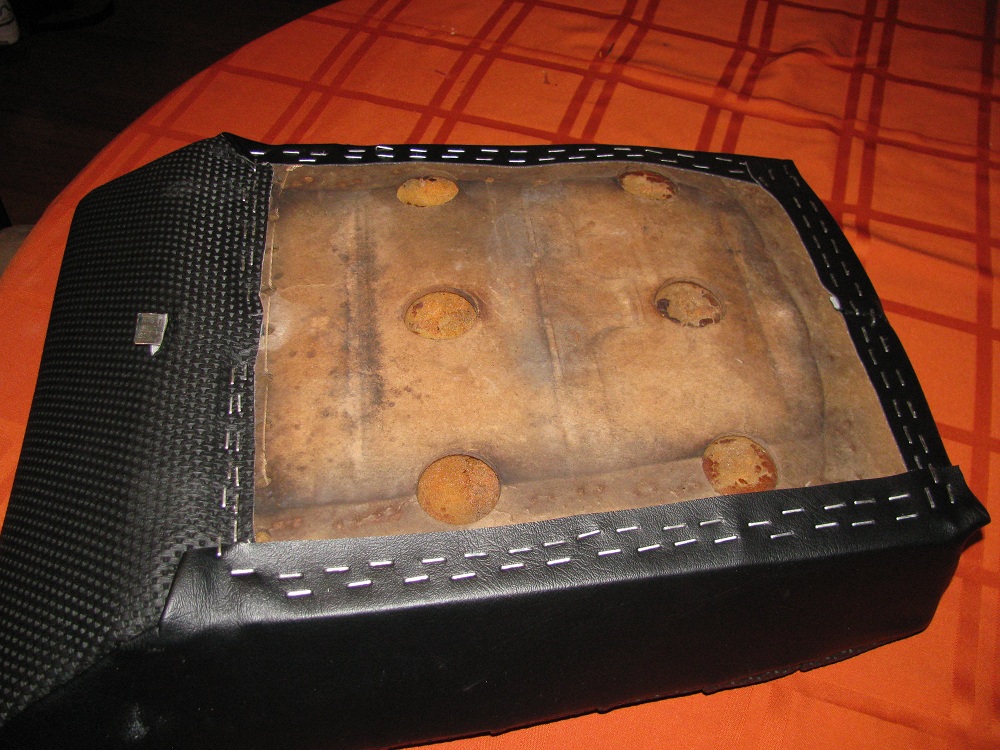

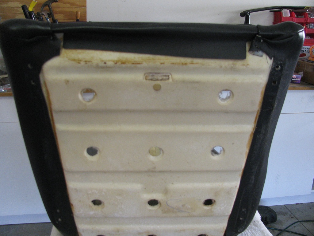

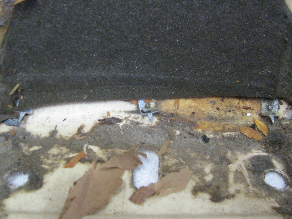

There are 2 metal points under the front seat, holding some tucked fabric onto the seat botton, release the fabric and straighten these points as well

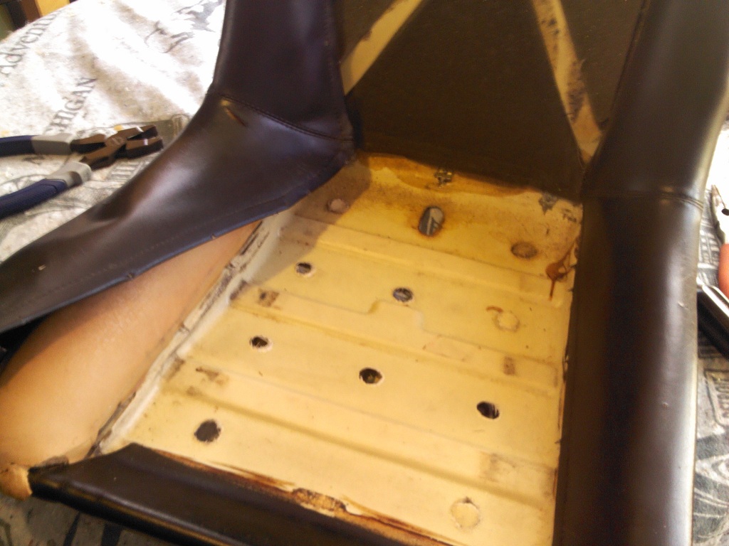

Now you release the points holding the bolster down, there are 10 or 12 on each side
The bolster comes off like a jacket, and will go back on the same way

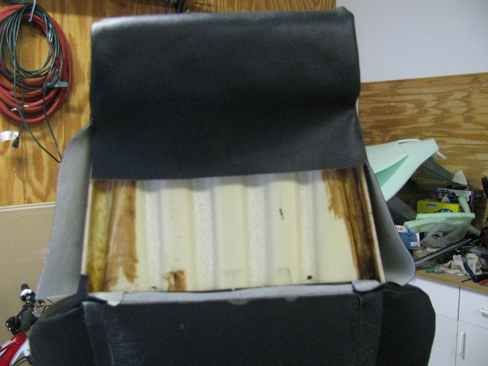

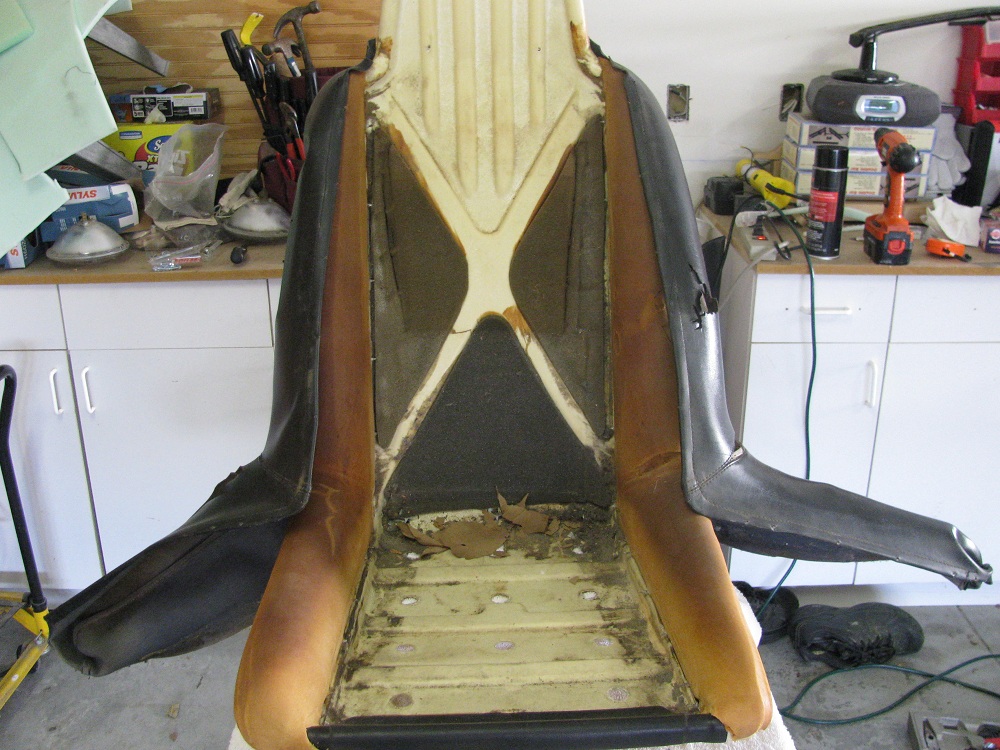

Don't forget to carefully remove this hard cardboard piece from the headrest flap, you will reuse this piece.

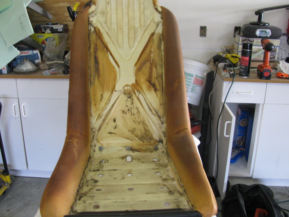

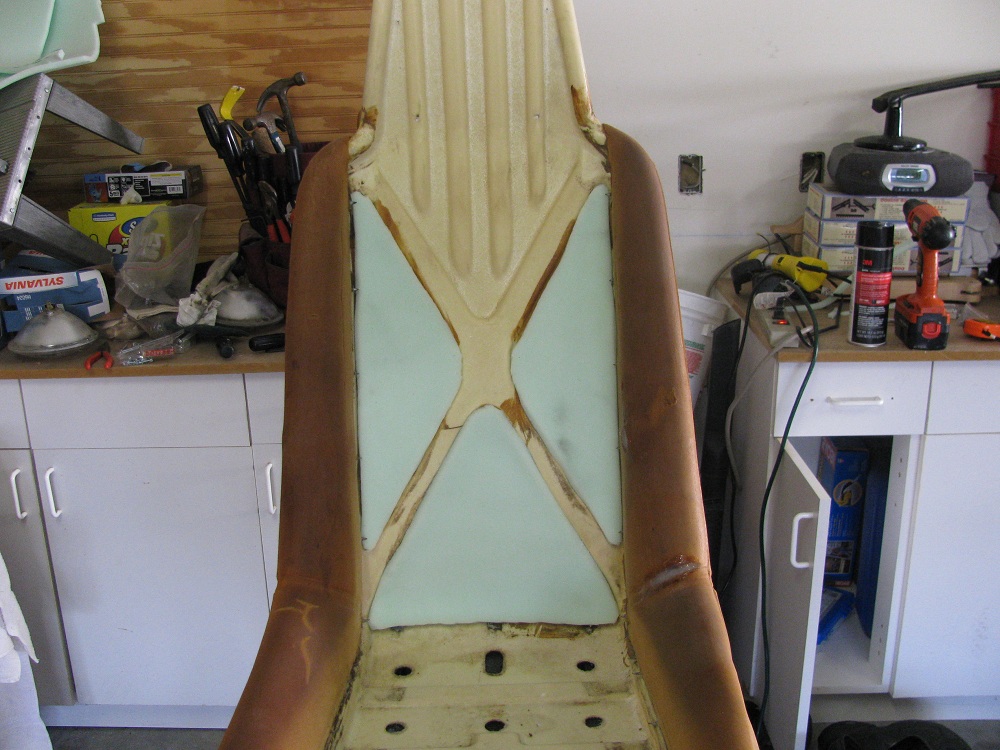

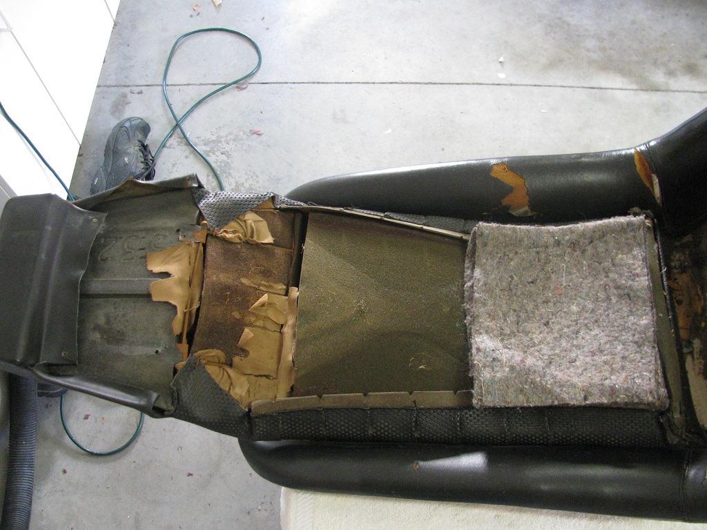

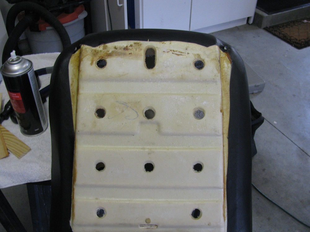

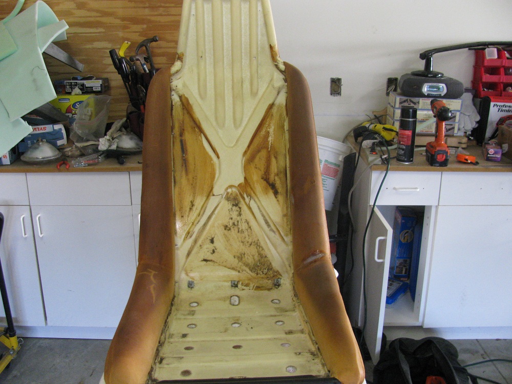

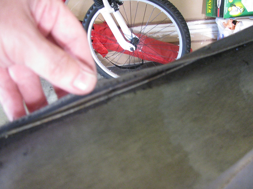

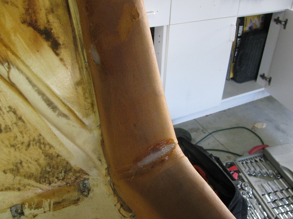

I also removed the nasty padding from the back of the seat, and added some clear silicone to the worst tear in the seat
and cleaned it to remove all the dust and crud

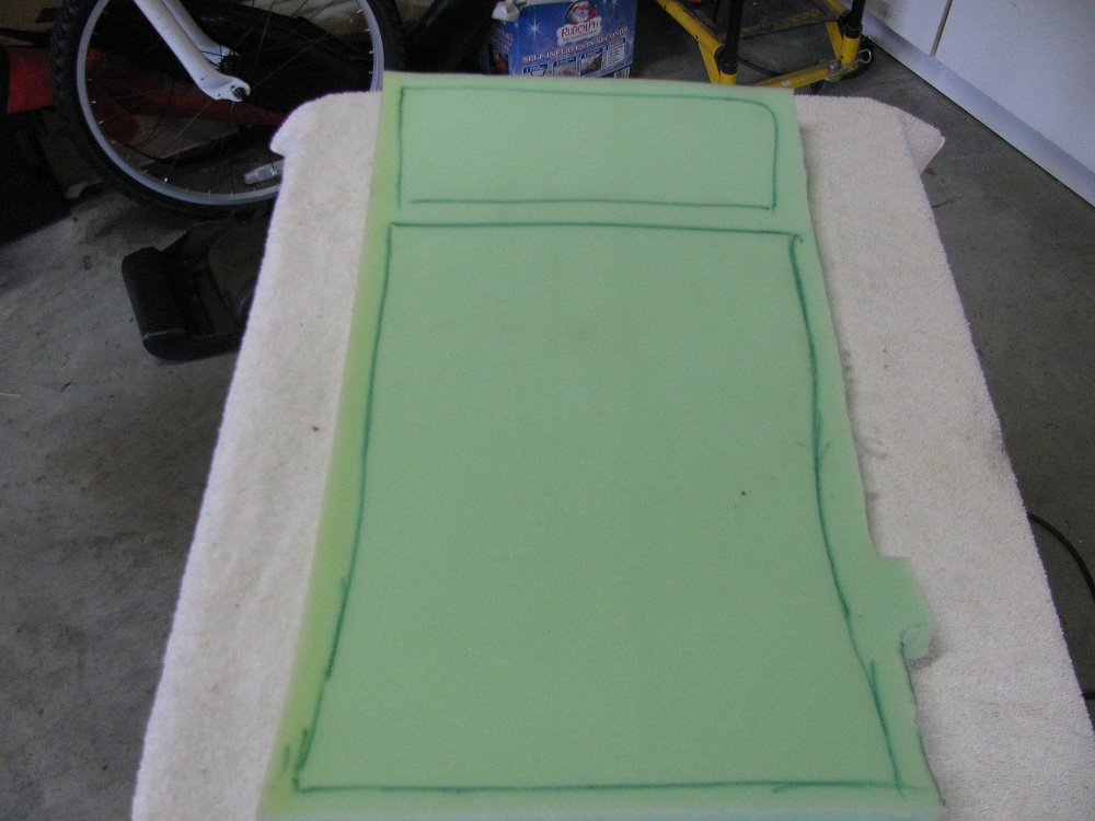

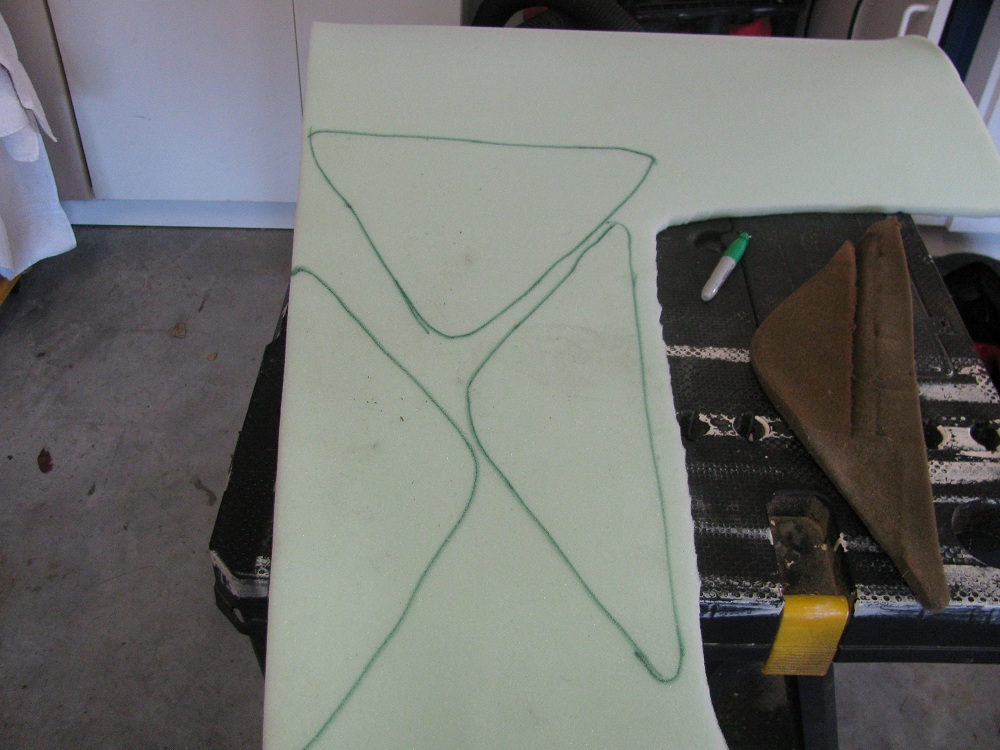

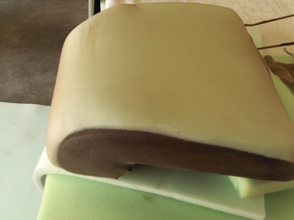

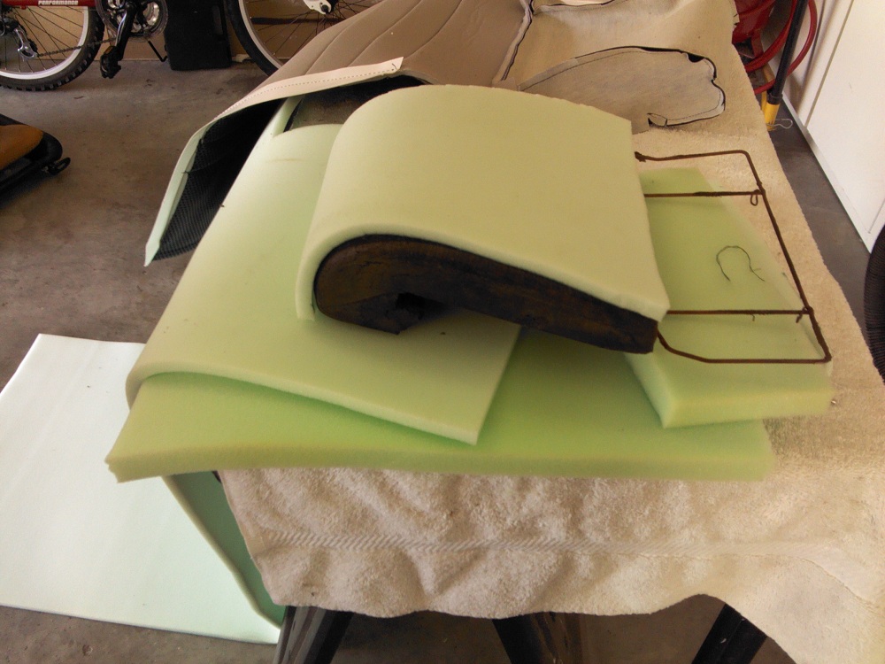

I traced the seat back padding and cut new pieces from 1/2" foam, cut it out and used contact adhesive to glue it down

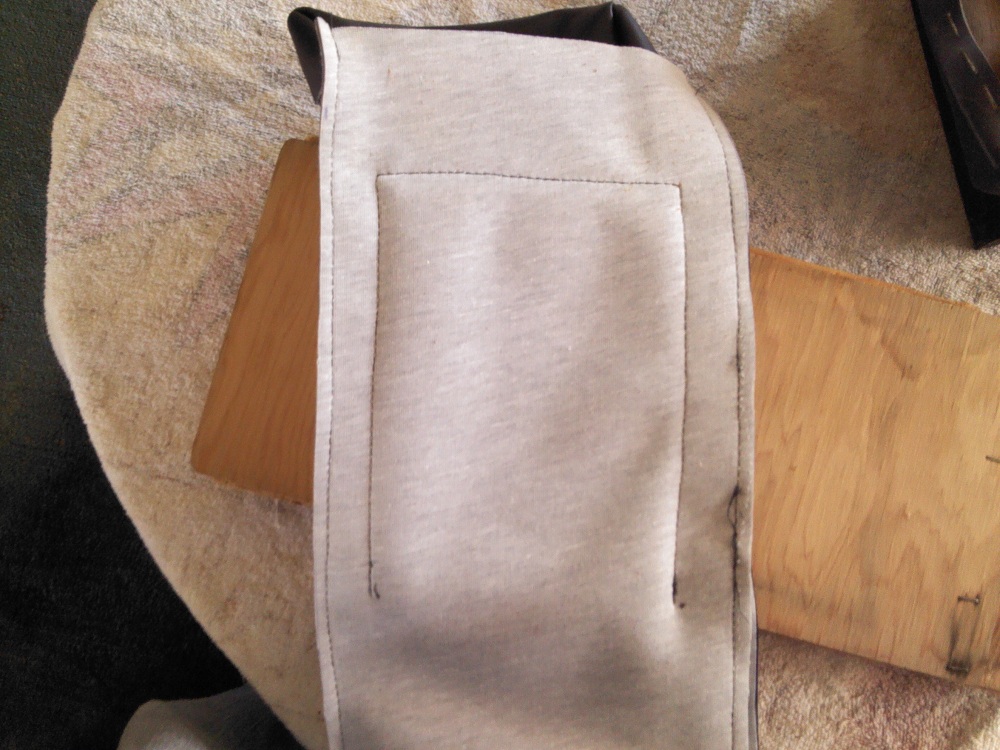

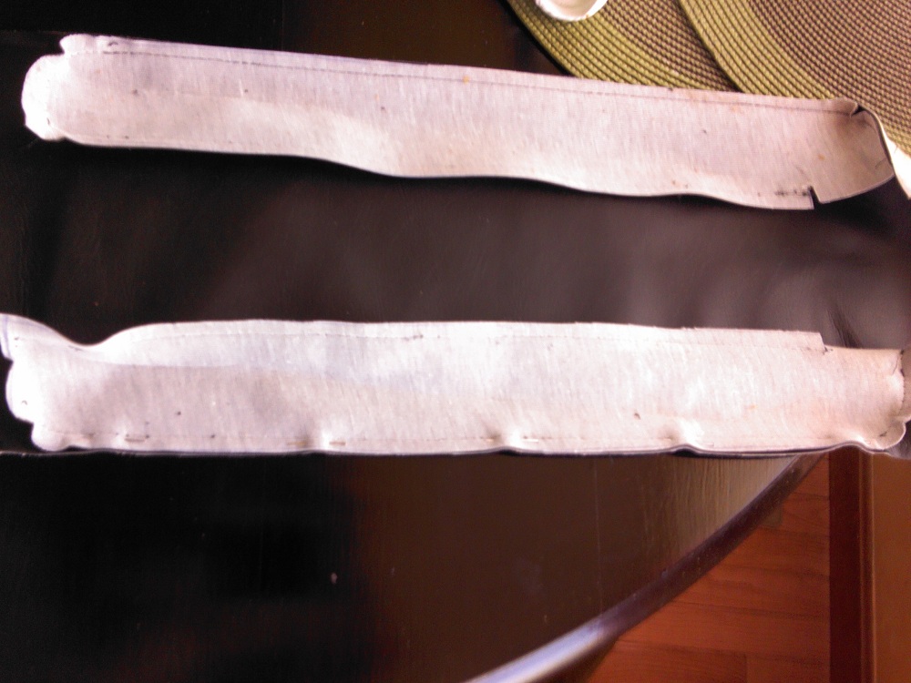

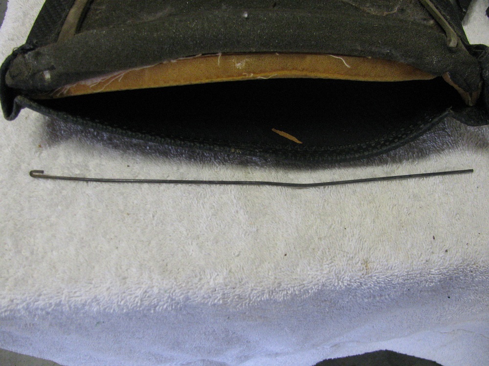

Next I had to remove the metal rod from the old seat bolster, and install it in the new seat bolster. To remove I simply split the seam with a razor blade and pulled it out, however you have to thread it down the sewn pocket/seam in the new bolster. This is kinda a pain, but must be done, take you time in the 'elbow' and having another pair of hands helps.

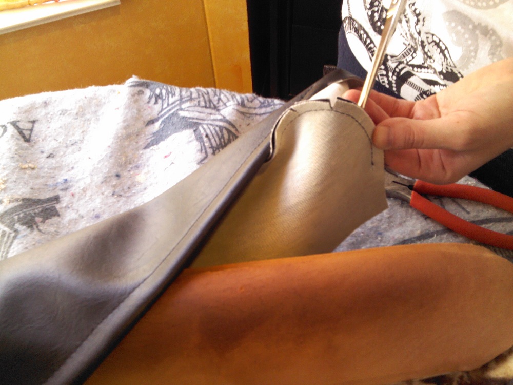

My wife cut some relief snips in the tightest corners and it does help the seam lay down in those tight radius(s)

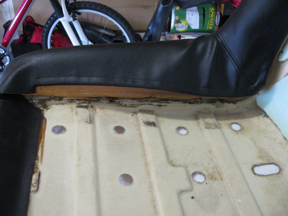

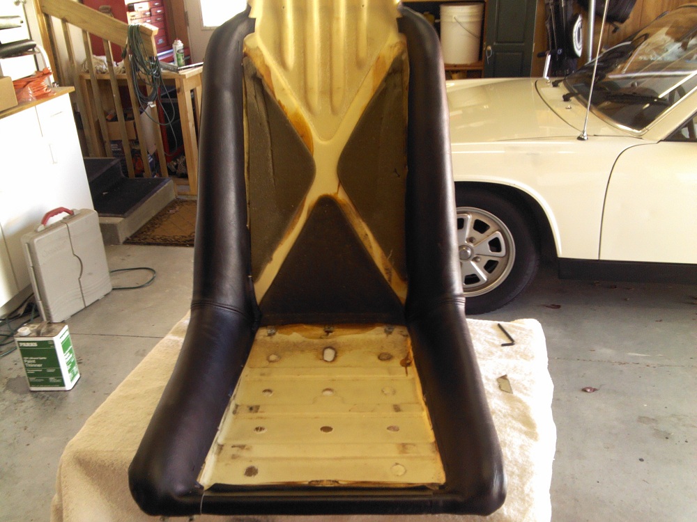

Now you put the new bolster back on (like a jacket from behind the seat frame), and get it lightly in place. You can see the points you will be using to secure it

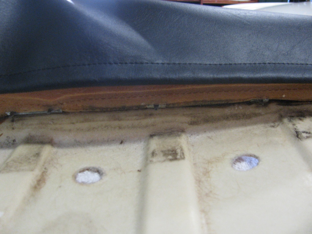

We found it easiest to secure the points first, then stretch and glue the bottom with contact adhesive
Don't forget to poke holes in the vinyl where the seat rail bolts go...

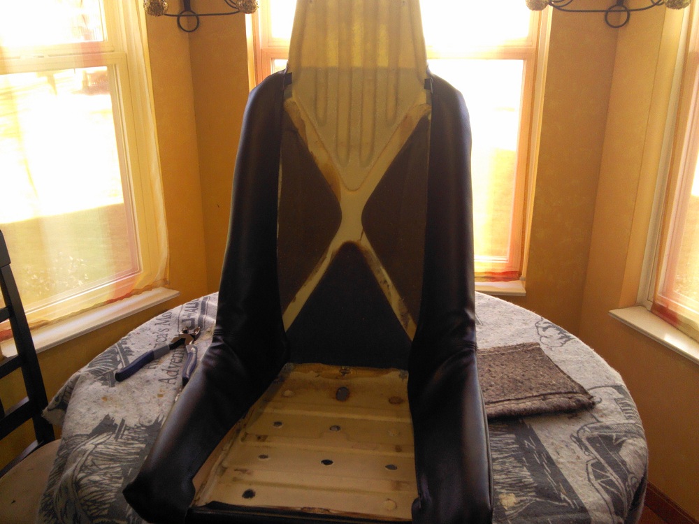

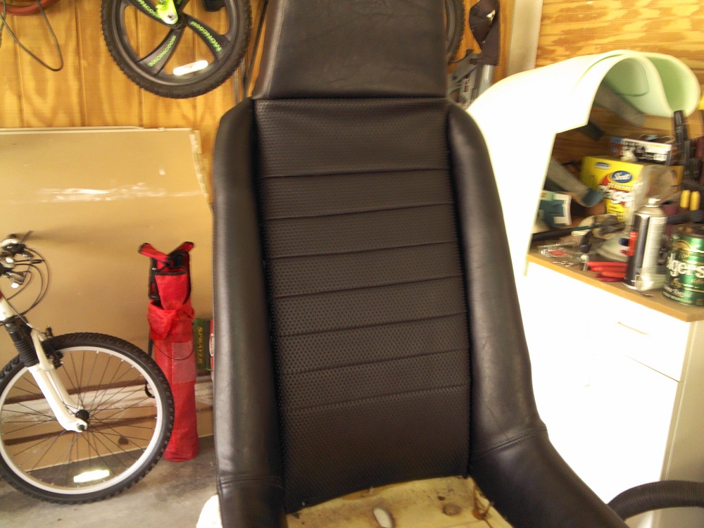

With the bolster basically done, we can turn to the seat back/headrest

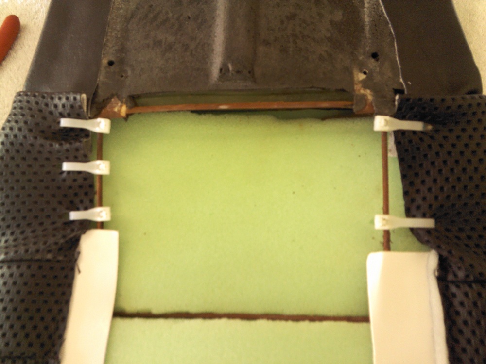

This pic shows the two metal rings that secure the seatback vinyl to the headrest, remove these to release the backpad from the headrest frame. I did not reuse these, I used plastic zip ties instead.

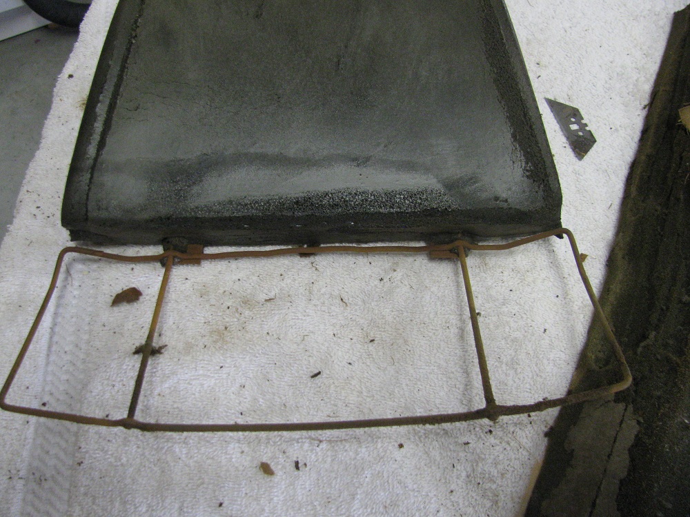

Remove the metal rod from the bottom of the backpad, you will reuse this as well, in the new backpad

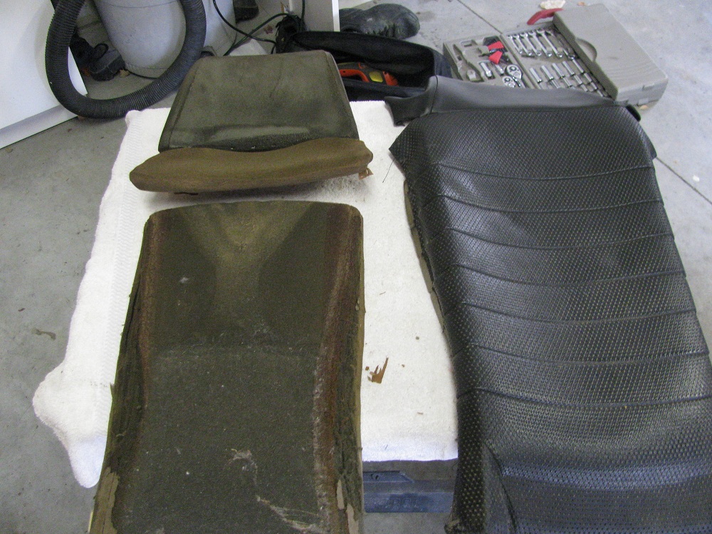

Seperate the foam from the vinyl, one of mine came apart easily, and the other, I had to use a razor blade to seperate it. They were glued to the foam originally, and you will repeat that process with the new one.
Remove the foam from the metal headrest frame. My frame was dirty/rusty, and I cleaned it up with scotchbrite pad. I decided to replace the old foam with new, and used 1" thick seat foam. I traced the old, and cut the new
I also added 1/2" foam to the headrest. After test fitting without, this took up the additional slack in the new headrest. I shaved the edge with sharp sissors to ease the transition.
I used a cut stocking stretched over the headrest to ease sliding it into the new headrest vinyl. I lightly glued the foam to the backpad, and then used the white cardboard to glue the backpad to the back of the foam.

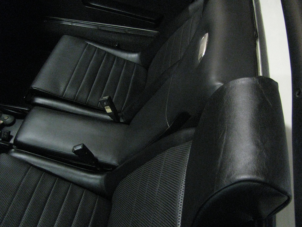

**Don't stretch to tightly here! The backpad narrows in the center but has wider "shoulders", and if you pull the wire ties too tight, the backpad won't fully fill the space at the top ** (ask me how I know huh.gif )

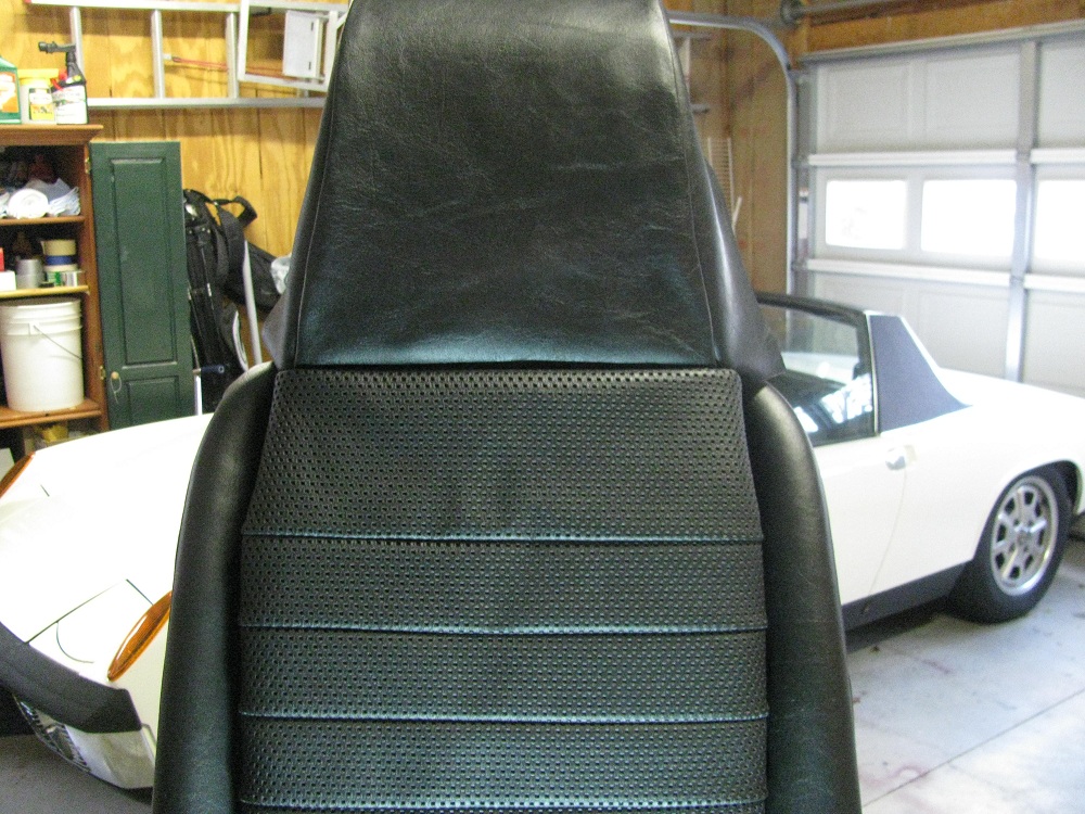

I put the two screws back into the bottom of the headrest here, to pull it in, and then using contact adhesive, glued the headrest fabric around the back of the seat frame for a tight fit. This came out pretty good, and the fit was nice with that extra 1/2" of foam on the headrest.
On the first seat I didn't glue in the flap cardboard until this point, got glue overspray everywhere. On the second seat, I glued it in prior to installing the bolster, much cleaner that way. The overspray cleans up easily, but avoiding it is best.
On this seat the top of the backrest is stretched to tighly (my fault), and I was careful not to make that mistake of the other seat. Another good reason to do one at a time, lessons learned and all.

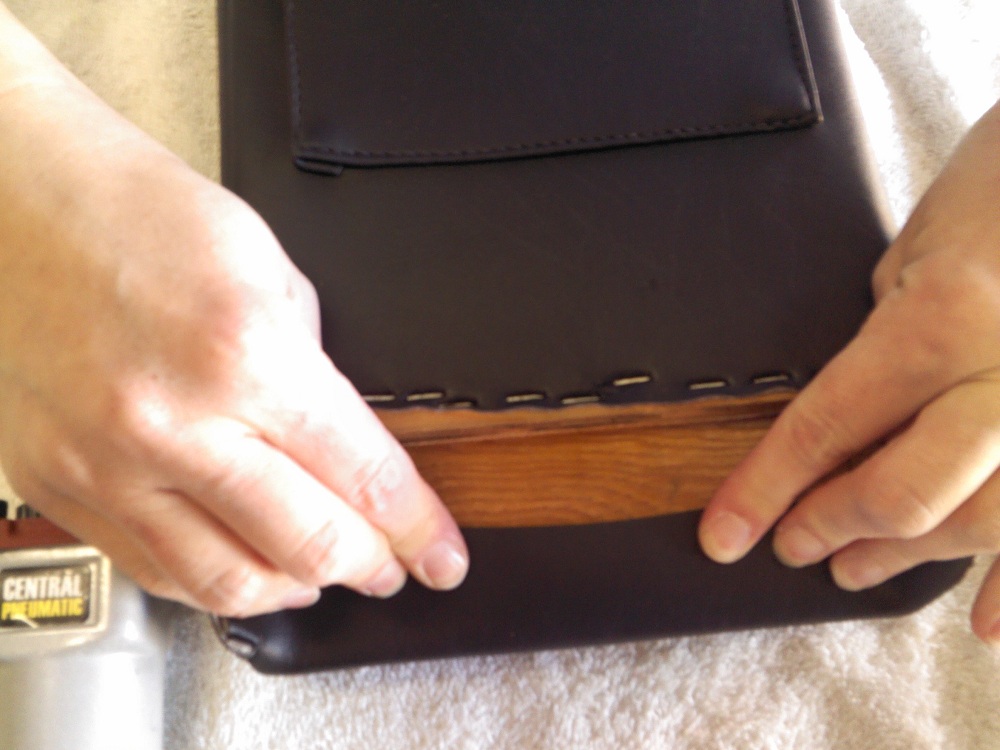

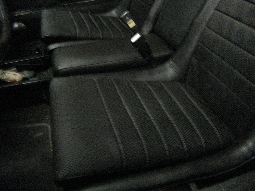

The seat bottom is very simple, I added some extra 1/2" foam to the "ass" portion of the seat, stretched and stapled (no glue needed). I bought a air stapler from HF for $20, well worth the money.

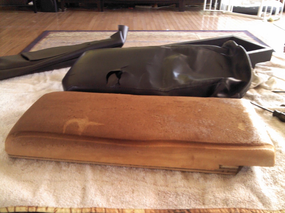

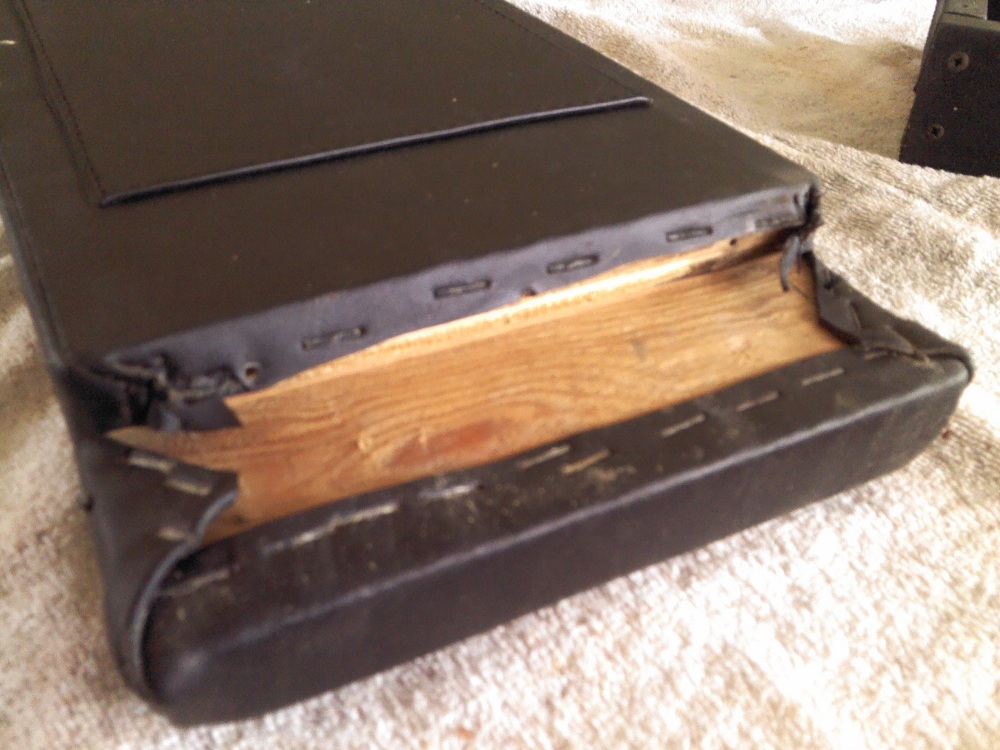

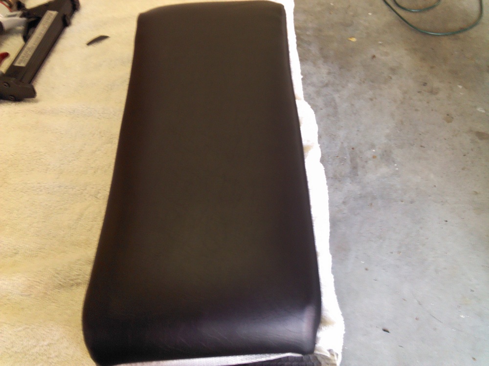

I bought a center console cover from a different vendor, much worse quality, with poor sewing and crooked seams. So bad in fact that my wife could not allow it, she took one of the seams apart, and re-sewed it, tightning it down as well, and it came out great. The misses saves the day! smilie_pokal.gif

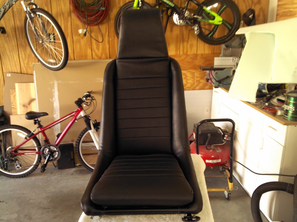

So the before:
and the after:
before:
after:
Hope this helps someone out with their project, it was certainly worth the time and effort.
