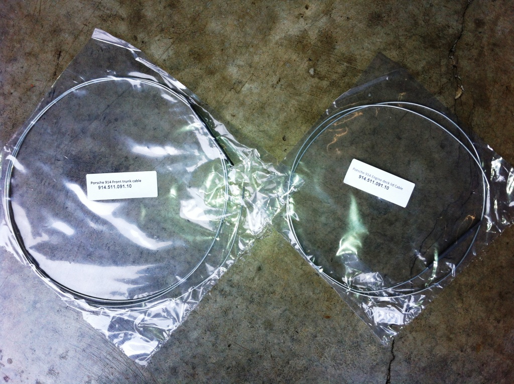

I decided to replace my front trunk cable since I need to us 100+ pounds of force to open it. I found some very small diameter braided wire to replace it. The latch side is very straight forward, but the handle end looks odd.
How does the cable attach to the handle?
The only thing I see is a flathead screw and before I took that out, I thought I would ask first. Also, is there a preferred end to start in fishing it back?
It appears that the handle is permanently attached to the body.

As it turns out you can not swap a new braided cable for the old metal one. That end is manufactured into the threaded end. No way to swap them. I simple pulled the old cable, sanded off the surface rust, greased the crap out of it, and put it back. Works great.

Yes, you can't just use a braded cable to replace it as it has a threadded termination that screws into the end of the handle. The other issue with these is the "sheath" that guides the cable can become worn, and it must be firmly affixed to the body to prevent flex as you pull.
