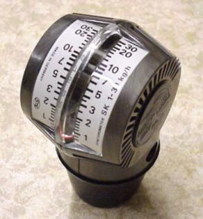

which carb tool are you using for synchronizing?
this one, i hope:
IPB Image
KT

Thanks for all the tips. I am using the older unisync tool. Maybe it's time to invest in a newer version.

euro911
The old style Unisyns do restrict the air intake ... the newer 'snails' are much better.
If your RPMs increase when you restrict the air, it's possible that your idle mixtures are adjusted too rich.
